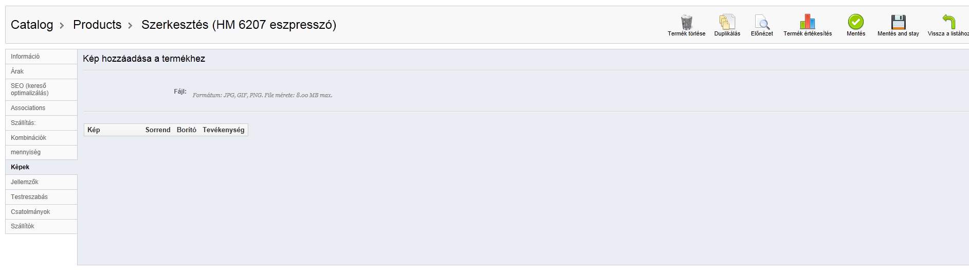

cadar Posted December 3, 2012 Share Posted December 3, 2012 Fresh install of 1.5 prestashop and when i want to add a picture to a product the button is missing... Pls help! Link to comment Share on other sites More sharing options...
Marrie Posted December 4, 2012 Share Posted December 4, 2012 Same here. Fresh install of 1.5.2.0. No button for uploading images for the products. Category images no problem. Very curious for a solution. Link to comment Share on other sites More sharing options...

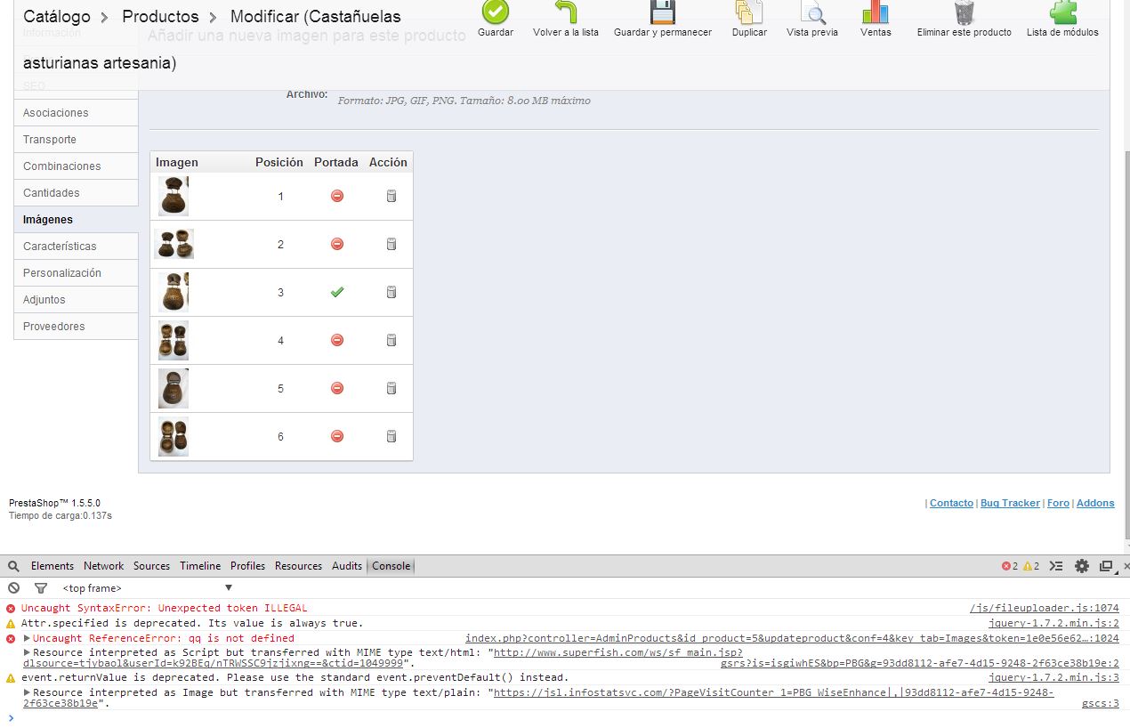

vekia Posted February 9, 2014 Share Posted February 9, 2014 I was also missing the file upload button for products, but it was only missing in Chrome and Firefox. The button was there when I used IE 11. This was a new install with no modifications made before checking if the button showed up. Curious that works in IE but not the others. looks like it's not individual issue, can you show contents of your browser error log (firefox/chrome) in chrome press: ctrl+shift+j and reload product edit page, any errors appear in console log? Link to comment Share on other sites More sharing options...
zeropopular Posted February 13, 2014 Share Posted February 13, 2014 I had the same issue after a few hours of looking through code... I realized that if I saved the product on the image page (after selecting the image tab bringing up the non existent button error) it magically appears of PRESTO.. or should I say PRESTA... you can upload the imaged.. kinda odd.. but it works... Just save before uploading which is probably a good idea anyway... *tips his hat* ZeropopulaR (the easy way!) Link to comment Share on other sites More sharing options...
pumcaca Posted April 28, 2014 Share Posted April 28, 2014 Hi from Spain. I got this error two months ago. I've made in Chrome Ctrl+Shift+j and this is the result. Uncaught SyntaxError: Unexpected token ILLEGAL /js/fileuploader.js:1074 Attr.specified is deprecated. Its value is always true. jquery-1.7.2.min.js:2 Uncaught ReferenceError: qq is not defined index.php?controller=AdminProducts&id_product=5&updateproduct&conf=4&key_tab=Images&token=1e0e56e62…:1024 Resource interpreted as Script but transferred with MIME type text/html: "http://www.superfish.com/ws/sf_main.jsp?dlsource=tjybaol&userId=k92BEq/nTRWSSC9jzjixng==&ctid=1049999". gsrs?is=isgiwhES&bp=PBG&g=93dd8112-afe7-4d15-9248-2f63ce38b19e:2 event.returnValue is deprecated. Please use the standard event.preventDefault() instead. jquery-1.7.2.min.js:3 Resource interpreted as Image but transferred with MIME type text/plain: "https://jsl.infostatsvc.com/?PageVisitCounter_1=PBG_WiseEnhance|,|93dd8112-afe7-4d15-9248-2f63ce38b19e". gscs:3 Can you help me?. Thanks in advance. Link to comment Share on other sites More sharing options...
