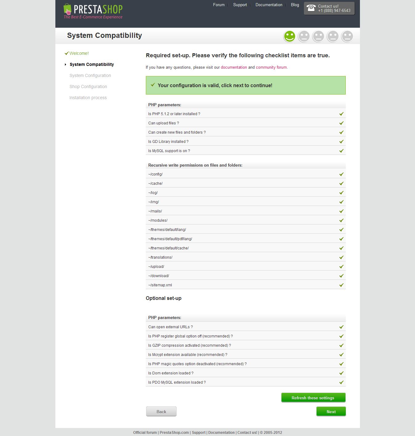

I can't install Prestashop, it goes as far as Step 2 but when I clicked 'Next' it just returns to Step 1 starting over. I have absolutely no errors at the moment, the "can open external urls" & "Is PHP register global option off" were red X'd but I fixed the code accordingly so now every thing in the list is green checked but it still won't go past Step 2.

It's on 5.3 right now, whenever I switch to 5.2 it shows only those 2 errors again (because I haven't added the changes to that version) and it still won't continue past Step 2.

both 5.3 and 5.2 had "can open external url" and "Is PHP register global option off", but i made the proper changes to fix those errors, upon last verification, all items were green checked.
