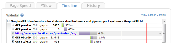

Guest Posted December 2, 2012 Share Posted December 2, 2012 I have just tried gtmetrix - what a great site (if frightening for me) I noticed on our site, that the time delay seems to be when the site switches from to standard url to the /en url Is this normal? We do have different languages installed, but if it having this kind of a hitch perhaps we should uninstall Link to comment Share on other sites More sharing options...
SuperCharlie Posted December 2, 2012 Share Posted December 2, 2012 I have just tried gtmetrix - what a great site (if frightening for me) I noticed on our site, that the time delay seems to be when the site switches from to standard url to the /en url Is this normal? We do have different languages installed, but if it having this kind of a hitch perhaps we should uninstall Without getting dirty and a lot of testing etc it is hard to tell. I think you always have to make a balance between speed and functions. It is always better to get rid of things you dont need, but if you do need them then you weigh the speed against the need. I have clients who have all kinds of crazy external stuff they simply cant live without that drag their site speed down. Its a trade off. I would use that tool to see if there are any glaring problems, not sweat it if the site performs to your satisfaction, and maybe try tweaking some things if the speed isnt what you want. In some cases, when youve tweaked until you are blue in the face, try some other hosting as that can bring huge differences.. And always always make backups..cuz ya never know when the next button you click or file you edit will crash the whole thing. Good Luck!! Link to comment Share on other sites More sharing options...

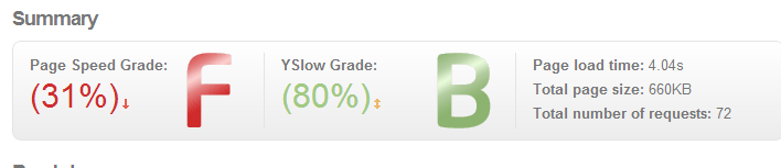

Guest Posted December 2, 2012 Share Posted December 2, 2012 Once again I use Ipage without any issues my site speed seems good, however I do not use any other languages, currencies and do not have layered navigation. Here is a link to my site so others can test just in case I am wrong. (been known to happen) http://team-shepherdusa.com/shop I suppose this is why we all have to be careful with stats. I have just ran your site and get these figures F 31% for page speed, but >80% on yslow At the end of the day I suppose what SuperCharlie said makes sense. Do't sweat on it if you sites performs well enough for you. There are so many factors that can be taken into account (not least location of server compared to location of user) Link to comment Share on other sites More sharing options...
