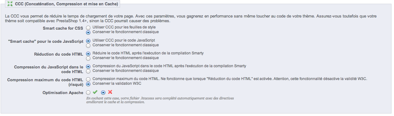

mart03 Posted November 28, 2012 Share Posted November 28, 2012 (edited) Hello, I applied what was said And it works! Look at the screenshot for the configuration. Thanks Edited November 28, 2012 by mart03 (see edit history) Link to comment Share on other sites More sharing options...

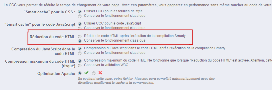

Fily123 Posted November 28, 2012 Share Posted November 28, 2012 (edited) Thanks a lot for the help. For me, this configution works fine : But i see It's different from your configuration Mart03 for exemple. So i'd like to know wich configuration is the most performant working with IE ? Thanks a lot Edited November 28, 2012 by Fily123 (see edit history) Link to comment Share on other sites More sharing options...
mart03 Posted November 28, 2012 Share Posted November 28, 2012 Thanks a lot for the help. For me, this configution works fine : But i see It's different from your configuration Mart03 for exemple. So i'd like to know wich configuration is the most performant working with IE ? Thanks a lot I don't know, i have just test with, this configuration and its works perfect ! So you do what you want Link to comment Share on other sites More sharing options...
Fily123 Posted November 28, 2012 Share Posted November 28, 2012 Yep It's true it's good when it works well...but it's better when it works very well Link to comment Share on other sites More sharing options...
mart03 Posted November 28, 2012 Share Posted November 28, 2012 Yea, of course You can try my config, and look on gtmetrix, maybe the website says a reply.. Link to comment Share on other sites More sharing options...
