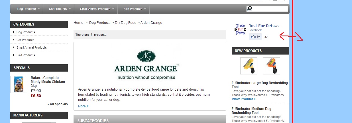

Greenpilgrim Posted November 16, 2012 Share Posted November 16, 2012 Hi Anyone have an idea if it is possible to make the background different to main body of the template? when i change the background colour it changes the whole of the page colour. What i would like is the main page to be white (in between the red lines), then the background a different colour ( marked in green). see pic If that makes sense. Using PS 1.4.7.0 with the 1.5 template any help or tips on how to do this would be appreciated. Many Thanks Chris Link to comment Share on other sites More sharing options...

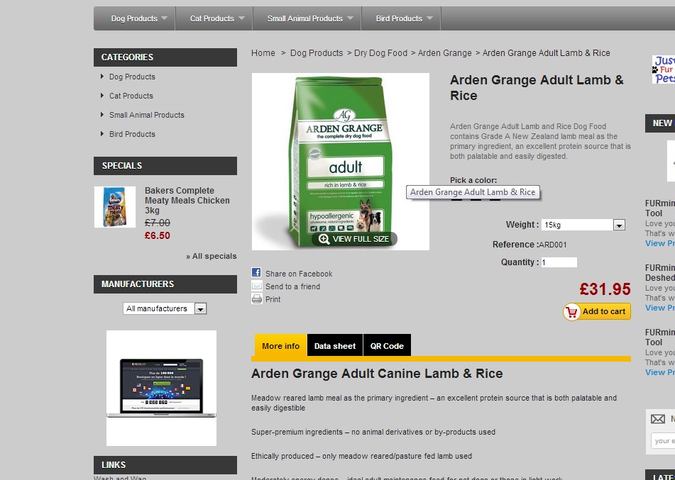

Greenpilgrim Posted November 16, 2012 Author Share Posted November 16, 2012 Hi Thanks for the info, however having looking at the global css, there does not seem to be a left right and center column in it with background color section. As you can see from the pic, when i change the background it changes the colour of the main body of the site, the center, left and right seems to be transparent and i can not see in the css where to change. i have attached the global css file and pic. Thanks Chris global.css Link to comment Share on other sites More sharing options...
vekia Posted November 16, 2012 Share Posted November 16, 2012 you have to add: #header, #columns, #footer {background:#FFFFFF} at the end of global.css file Link to comment Share on other sites More sharing options...

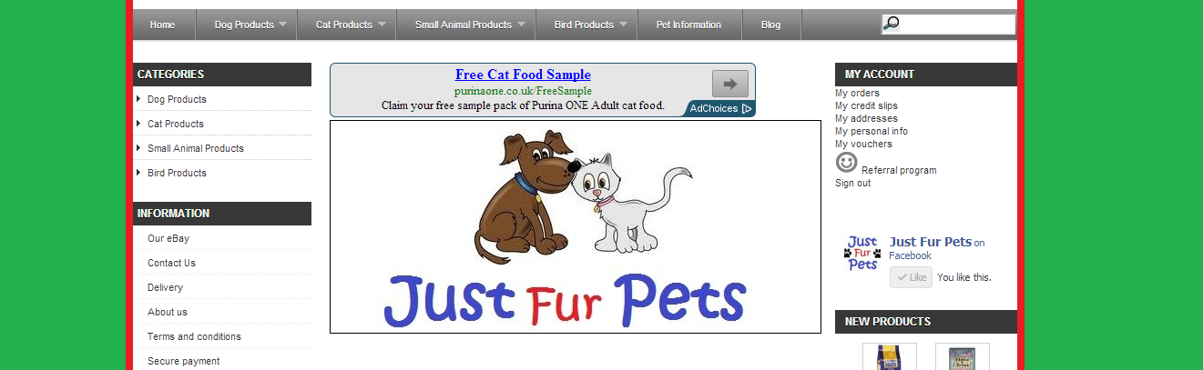

Greenpilgrim Posted November 16, 2012 Author Share Posted November 16, 2012 Sorry to be a pain 1 last question. Is it possible to extend slightly some how so there is a little bit of white on the left and right, as it looks like it cuts off abit , if you know what i mean. See Pic, Thanks Chris Link to comment Share on other sites More sharing options...
vekia Posted November 16, 2012 Share Posted November 16, 2012 (edited) Sorry to be a pain 1 last question. Is it possible to extend slightly some how so there is a little bit of white on the left and right, as it looks like it cuts off abit , if you know what i mean. See Pic, Thanks Chris you must add padding parameter: #header, #columns, #footer {background:#FFFFFF; padding:5px;} Edited November 16, 2012 by vekia (see edit history) Link to comment Share on other sites More sharing options...
Greenpilgrim Posted November 16, 2012 Author Share Posted November 16, 2012 Perfect, Thank you Chris Link to comment Share on other sites More sharing options...
