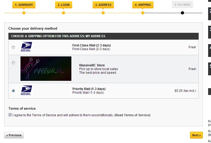

The First Class Mail is killing me. I can't get that to show up with a proper charge. It either doesn't show up or shows up as free. I've tried both commercial and regular rate. Screw it, I'm just going to give free shipping on everything and raise my prices. Thanks for the help

OK, so I've uninstalled UPS and reinstalled USPS like 4 times and still can't get the shipping I need.
If you order the Mini Pet red or yellow, it ships via USPS medium flat rate box and costs only $10.85 anywhere in the continental US, you can use Santa Barbara, CA 93103 to calculate manually using commercial rates.
If you order any accessories, they all are very light and can be sent via First Class for $1.50 in a bubble wrap envelope, maximum weight for multiple accessories is like .16 LBS. Once you go over that then the accessories are sent via USPS small flat rate box and costs only $5.15 anywhere in the continental US, you can reuse Santa Barbara, CA 93103 to calculate manually using commercial rates.
Now.........if you purchase a Mini Pet AND accessories, you only pay the Mini Pet shipping price as all accessories will be shipped in that same box.
I only need 3 shipping prices:
1 Mini Pet alone or Mini Pet with accessories: $10.85 via USPS medium flat rate box
2 Small quantity of accessories: First Class Mail $1.50
3 Larger quantity of accessories: $5.15 via USPS small flat rate box
Should I just completely uninstall the USPS shipping module and let PayPal's shipping calculator do the work from the weights set in each product's shipping specs?

Hey Benjamin, it's calculating the shipping costs for Priority at half of what it should be. It calculated a Mini Pet to Florida for just $6.85 when it should be $11.35 The weight of the product is 1.6lbs or 1lb 10 ounces
Cost of the Mini Pet is $50.

Please tell me there's a new patch that fixes all the shipping bugs in Prestashop. I can't get it to accurately show shipping and when it gives free shipping without rhyme or reason. I otherwise love Prestashop. Maybe I'll just give free shipping and jack all my prices up.

I see on you site that Paypal Quick Checkout is enabled. When I press that now shipping costs are applied.
At least I would deactivate that untill you know how this really works. I would recommend that before going live you first test and understand the software untill you really find comfortable. Building a website in one week, going live without any tests. erm, yeah can do that but you can not complain about the result.
Best regards, trip
No problem, I can understand that, I did not test if this Express Checkout Shortcut which is recommended to enable during module setup is able to calculate shipping costs. At least they should mention that in the paypal module!! Otherwise this is really misleading.

You could look into admin/catalog/products tab 'warehouse'. Are the product connected with a warehouse? This solved my problem with alway free shipping and solved the problem with 'no carrier available for this address' in checkout.
I'm using 1.5.3
