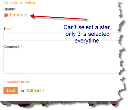

nellybongo Posted November 14, 2012 Share Posted November 14, 2012 Hi All, I am completely new to this and was hoping someone could help me, I am having problems with the inbuilt review system under the Product Comments Module, For some unknown reason the rating stars are always stiuck on 3, it wont allow you to select any other number, I think it maybe a javascipt conflict, Has anyone come across this before, i`m using 1.5.2, new install with responsive theme, The site can be viewed here I will be quite happy to pay a small amount for any help with this as I need a good review system, Or does someone know of one I can purchase, I have already tried one from egrovesystem.com but it completly messed up the theme and put me back a week. Any advice or help would be most grateful. Link to comment Share on other sites More sharing options...

nellybongo Posted November 15, 2012 Author Share Posted November 15, 2012 Hi guys, I have attached a picture to show you whats happening. Link to comment Share on other sites More sharing options...
