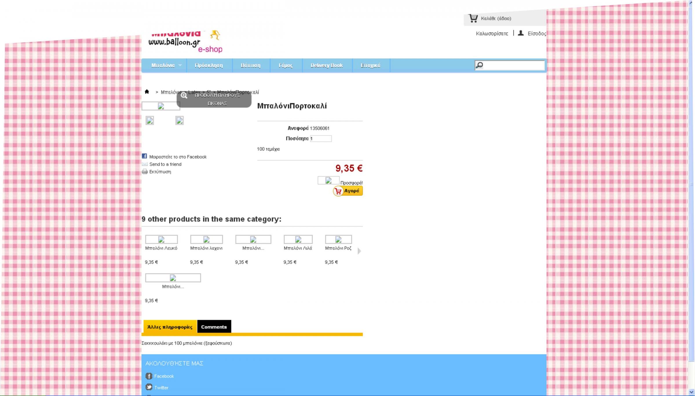

bouketoballoons Posted November 14, 2012 Share Posted November 14, 2012 Hello I have uploaded some products via csv import and I tried to upload the images separately. I made an 600X600 pixel images and then uploaded via -- images in products section. Then I went to preferences-products - regenerate thubnails But nothing, none of the picture is displayed. I cant figure why this is happening, Thanks Link to comment Share on other sites More sharing options...

steve_c Posted November 14, 2012 Share Posted November 14, 2012 Right click (properties) one of the erroneous images and check the path. What does it say? Link to comment Share on other sites More sharing options...

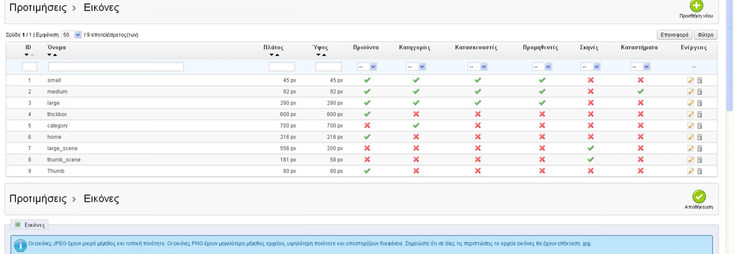

Letsrock Posted November 14, 2012 Share Posted November 14, 2012 There is an issue with "_default" in the pictures or the code. We have the same problem with v1.5.2.0 At the moment we create the pictures with your settings in the second picture and then we add "_default" to every Name and create them new without deleting the old one via the box at the bottom. I hope they will correct this issure in the next update. Link to comment Share on other sites More sharing options...
steve_c Posted November 14, 2012 Share Posted November 14, 2012 ^ I had that same problem. I deleted the image name "Home" and regened thumbs for "Home_Default". Link to comment Share on other sites More sharing options...
