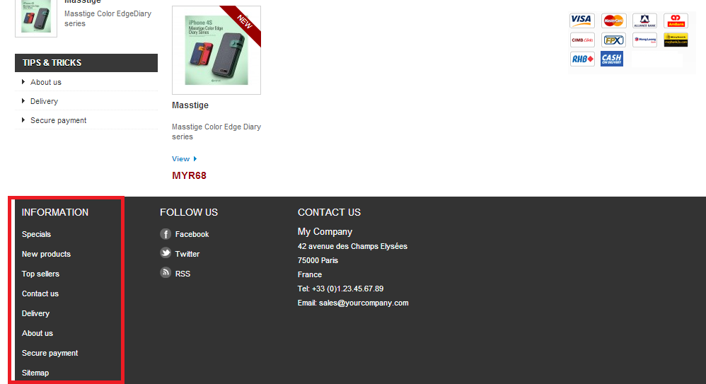

sdas86 Posted November 10, 2012 Share Posted November 10, 2012 Hi all, I would like to know how to change the links in the Information of my prestashop footer. Any idea how to remove and add some links? Thanks. My prestashop: http://articlepinger.com/presta/index.php Link to comment Share on other sites More sharing options...
nadie Posted November 10, 2012 Share Posted November 10, 2012 Hi all, I would like to know how to change the links in the Information of my prestashop footer. Any idea how to remove and add some links? Thanks. My prestashop: http://articlepinger...resta/index.php Tab - Modules -> Search -> Block CMS -> Configure (You can configure (disable, enabled links cms, and have a box of text to add new lines) Some links, you have to modifying the file: modules/blockcms/blockcms.tpl Sorry for my English 1 Link to comment Share on other sites More sharing options...

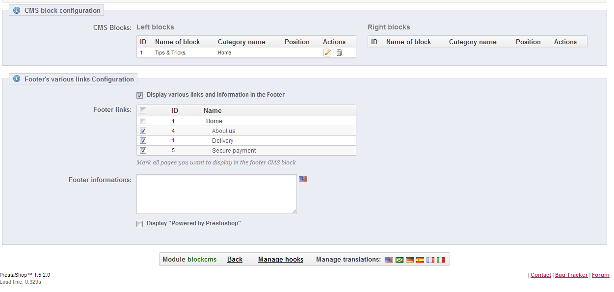

yaniv14 Posted November 10, 2012 Share Posted November 10, 2012 Nadie is right, If you want to remove it completely you need to Unhook from back office modules/position (Footer) If you want to make changes you can remove or add some links from block cms configuration (like the image you attached) and the rest of the links you need to edit the file modules/blockcms/blockcms.tpl and remove the links from there. on the left column you hooked another box of the cms 1 Link to comment Share on other sites More sharing options...

yaniv14 Posted November 10, 2012 Share Posted November 10, 2012 go to your back office to modules -> modules -> CMS Block and press configure. you will see: Left block , Right block & Footer. There you can add or remove anything you like, you probably will have Tips & Tricks on the left blocks and Information on the footer. If you want to remove completely the Information from the footer you need to Uncheck "Display various links and information in the Footer" 1 Link to comment Share on other sites More sharing options...

eStorePower Posted March 29, 2013 Share Posted March 29, 2013 (edited) INFORMATION FOOTER: (Presta 1.5.3.1) Removing.... 1. "Our Stores" link -- Preferences > Store Contacts > Set the Display Our Stores to "No" 2. "Specials", "New Products", "Top Sellers", -- / Themes / Default / Modules / blockcms / blockcms.tpl {if !$PS_CATALOG_MODE}<!-- li class="first_item"><a href="{$link->getPageLink('prices-drop')}" title="{l s='Specials' mod='blockcms'}">{l s='Specials' mod='blockcms'}</a></li -->{/if} <!-- li class="{if $PS_CATALOG_MODE}first_{/if}item"><a href="{$link->getPageLink('new-products')}" title="{l s='New products' mod='blockcms'}">{l s='New products' mod='blockcms'}</a></li --> {if !$PS_CATALOG_MODE}<!-- li class="item"><a href="{$link->getPageLink('best-sales')}" title="{l s='Top sellers' mod='blockcms'}">{l s='Top sellers' mod='blockcms'}</a></li -->{/if} 3. Removing / Adding Links --- / Modules / BlockCMS / Configure (note: You can also hook the Category Block from Left to Right) @sdas86 your "Tips & Tricks" has the default name "Information" Fashion eStore - http://fashion.estore.net46.net Edited March 29, 2013 by eStorePower (see edit history) 1 Link to comment Share on other sites More sharing options...
