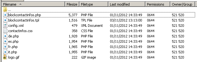

bellini13 Posted November 4, 2012 Share Posted November 4, 2012 does it include a module? or just a .tpl file under the theme folder? if you'd like to provide me FTP access via PM, i can take a look to confirm. Link to comment Share on other sites More sharing options...
christillis Posted November 4, 2012 Author Share Posted November 4, 2012 it includes a module with the following files (see attached pic) I can happily set up ftp for you if needed. Thanks mate. Link to comment Share on other sites More sharing options...
bellini13 Posted November 5, 2012 Share Posted November 5, 2012 so it seems the theme would include the module, perhaps that is for compatibility with v1.4 of prestashop. With v1.5 it is a core module. Link to comment Share on other sites More sharing options...
