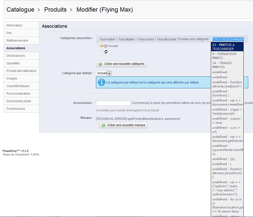

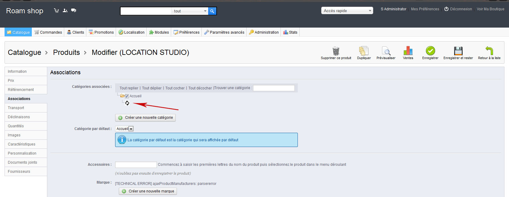

jam' Posted October 27, 2012 Share Posted October 27, 2012 (edited) Hye everyone... I have problem with categories, and products on shop I'm trying to set up : http:://roam.fr/shop/index.php when I add product, on left menu (association), the update gif turns and turns with no end ; and no categories to link product display. is there any way to fix this ? This is my main problem. Got tons of others :-D :-D Edited October 27, 2012 by jam' (see edit history) Link to comment Share on other sites More sharing options...

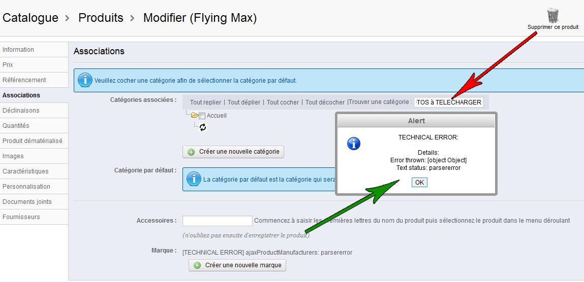

jam' Posted October 28, 2012 Author Share Posted October 28, 2012 (edited) I just had a new try to link product to its category. I did change the way : type in search category. After two letters typed in the search box (red arrow) the name of category displayed (which shows me the categories are detected at least), I did choose the one, and a popup (green arrow) displayed with this warning. Any idea that helps someone ? Edited October 28, 2012 by jam' (see edit history) Link to comment Share on other sites More sharing options...
pattuka Posted May 8, 2013 Share Posted May 8, 2013 Hello, I have the same problem in a new install of prestashop 1.5.4.1 Did you solve the problem finally? Best regards, Jaime. Link to comment Share on other sites More sharing options...
pattuka Posted May 9, 2013 Share Posted May 9, 2013 I discovered that, at least in my case, this happens if the admin folder is renamed from the original one just renamed after the prestashop installation. If I go back to the original name, this feature works again. Link to comment Share on other sites More sharing options...
