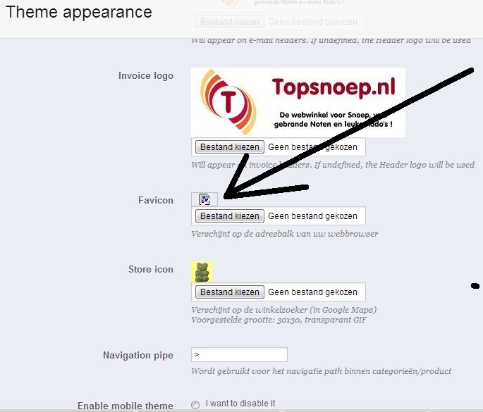

In my PS 1.5.2 I find it impossible to define an icon. No matter what I upload - I keep seeing the broken image

For example I attached the ICO file that I am uploading in the ADMIN ... Guess what? It shows a broken image as in the first post. Not only that, but the Store icon in the admin has automatically restored to Prestashop's icon.
It is definately not resolved. Please check out the images attached and thanks for answering :)

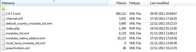

I've got another idea, can it be a setting from the database? I noticed that some of the problems I had were all related to database because 99% siteground only updated the files...
Yes, I was just looking at that but first go to your store/config/xml/1.5.2.xml file and search for two lines of code that contain the word favicon. Do they say favicon.ico or favicon.jpg?
Edit:
Also in your store/admin/autoupgrade/latest/prestashop/install/data/xml/configuration.xml file, there should be something like this:
Oh no... mine is called 1.4.7.3.xml !!!

  On 11/23/2012 at 8:52 AM, xenobius said:
This is what I have
I have all those other files in there.
I have a program that compares files. If you want to PM me your 1.4.7.3.xml file, I'll compare it to my 1.5.2.xml and see if there are any differences. I'm not even really sure that this could be an issue though. Who knows? It may be.
