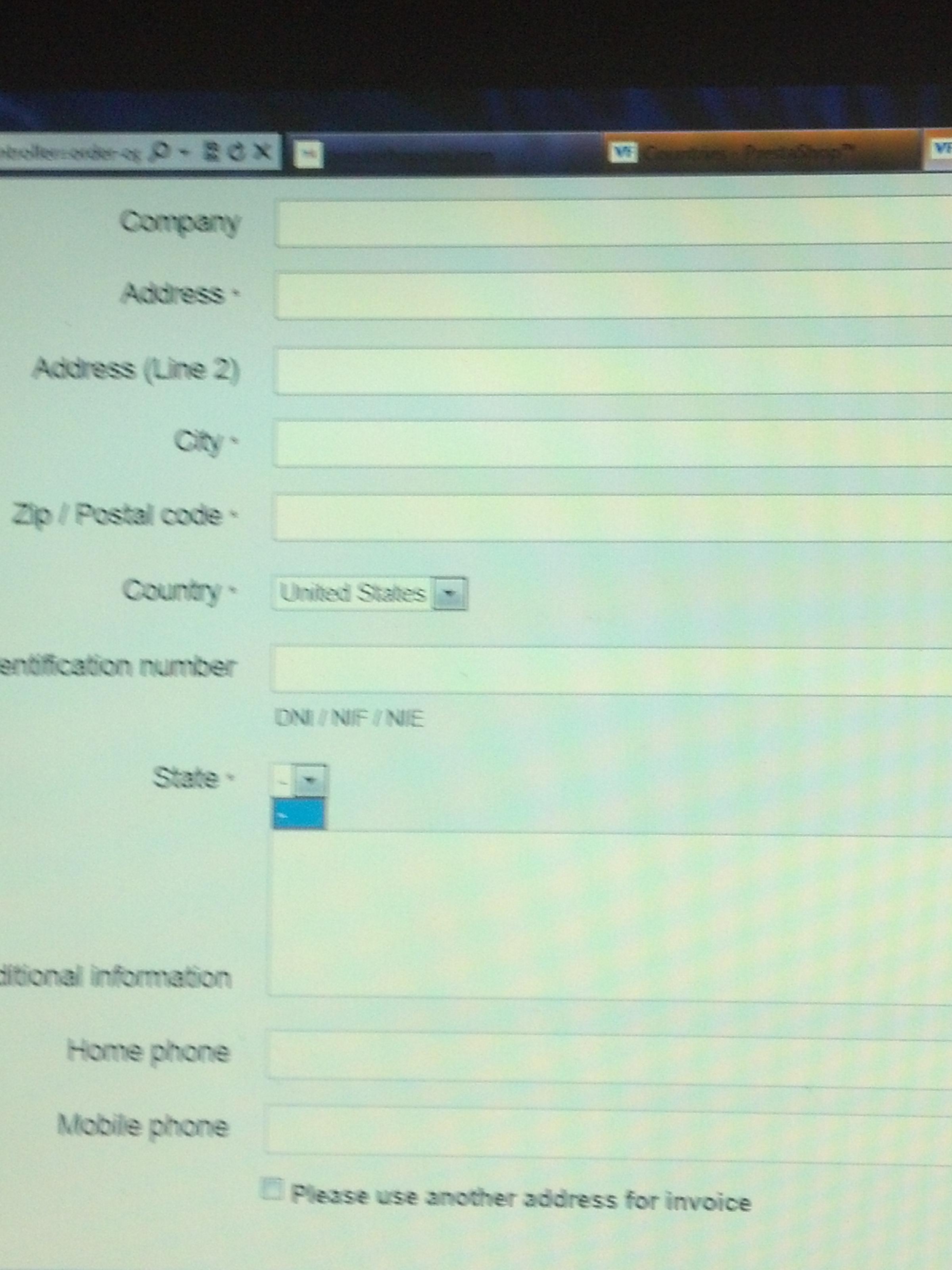

vinylfreaks Posted October 31, 2012 Share Posted October 31, 2012 Marty, thanks for the photo! It helped to get the state choice to show up in the customers address field, but do you know how to make the states appear in the drop down menu? All that shows up is a '-' and no state names. Link to comment Share on other sites More sharing options...
vinylfreaks Posted October 31, 2012 Share Posted October 31, 2012 Sorry for the poor picture, but you get the idea. Link to comment Share on other sites More sharing options...
