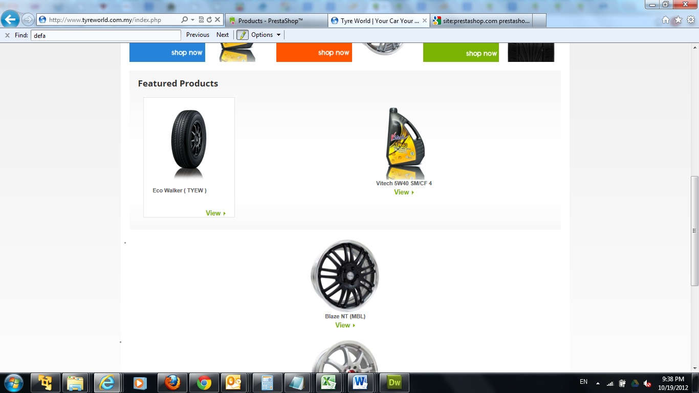

vicren Posted October 19, 2012 Share Posted October 19, 2012 whenever i switch to catalog mode, the home feature display will go out of align. any advice that can solve this problem thank your for your kindness reply. Link to comment Share on other sites More sharing options...
Carolina Custom Designs Posted October 20, 2012 Share Posted October 20, 2012 I looked at your site and you have something very strange going on. The unordered list is closing after the first list item. This is causing the rest of the list items to be completely unstyled and out of order. Without further access to your theme it is really hard to say what is causing this. Marty Shue Link to comment Share on other sites More sharing options...
