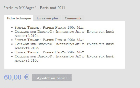

Karldupont Posted October 11, 2012 Share Posted October 11, 2012 Do someone know why I get a strange prblem in the datasheet area of my products the item appears three times instead of one. ??? Link to comment Share on other sites More sharing options...
shacker Posted October 15, 2012 Share Posted October 15, 2012 in default theme is the same? Link to comment Share on other sites More sharing options...
Karldupont Posted October 15, 2012 Author Share Posted October 15, 2012 Hi Yes same with default theme sometimes the duplicates go out with some products but it's still there when I post a new product: now just 2 instead of 3... very strange Link to comment Share on other sites More sharing options...

Karldupont Posted October 18, 2012 Author Share Posted October 18, 2012 I just tried but noting happened always the same bug (before I used to work with prestashop 1.5 0.17 with this add modules and all was ok no bug, so it's a bug with prestashop 1.5 1.0 I suppose) Link to comment Share on other sites More sharing options...

Federman Posted March 1, 2013 Share Posted March 1, 2013 Hello Benjamin and Aldi Thanks for your reply. I have the version 1.5.2 The answer of "Aldi M" helped me a lot, and locate the error is in the new products module. http://forge.prestas...owse/PSCFV-4913 Thank you very much. Link to comment Share on other sites More sharing options...

Aldi M Posted March 2, 2013 Share Posted March 2, 2013 @BnB: Hmmm... not sure but I'm guessing it's due to the different version you're using. I used v.1.5.2. Try search for 'function cacheFrontFeatures' in your editor. It should be in the 3rd line from the bottom within that function that you should change from this: self::$_frontFeaturesCache[$row['id_product'].'-'.$id_lang][] = $row; ...to this: if (!isset(self::$_frontFeaturesCache[$row['id_product'].'-'.$id_lang][$row['id_product']])) self::$_frontFeaturesCache[$row['id_product'].'-'.$id_lang][$row['id_product']] = $row; Take note, though, that I haven't tried this myself as I already hacked my theme to fix this issue before I found this solution. Link to comment Share on other sites More sharing options...
Federman Posted March 2, 2013 Share Posted March 2, 2013 You have to change the function code (cacheFrontFeatures) in the / classes / product.php line 3162 or 3169. And replace it with the following code: public static function cacheFrontFeatures($product_ids, $id_lang) { if (!Feature::isFeatureActive()) return; $product_implode = array(); foreach ($product_ids as $id_product) if ((int)$id_product && !array_key_exists($id_product.'-'.$id_lang, self::$_cacheFeatures)) $product_implode[] = (int)$id_product; if (!count($product_implode)) return; $result = Db::getInstance(_PS_USE_SQL_SLAVE_)->executeS(' SELECT id_product, name, value, pf.id_feature FROM '._DB_PREFIX_.'feature_product pf LEFT JOIN '._DB_PREFIX_.'feature_lang fl ON (fl.id_feature = pf.id_feature AND fl.id_lang = '.(int)$id_lang.') LEFT JOIN '._DB_PREFIX_.'feature_value_lang fvl ON (fvl.id_feature_value = pf.id_feature_value AND fvl.id_lang = '.(int)$id_lang.') LEFT JOIN '._DB_PREFIX_.'feature f ON (f.id_feature = pf.id_feature) WHERE `id_product` IN ('.implode($product_implode, ',').') ORDER BY f.position ASC'); foreach ($result as $row) { if (!array_key_exists($row['id_product'].'-'.$id_lang, self::$_frontFeaturesCache)) self::$_frontFeaturesCache[$row['id_product'].'-'.$id_lang] = array(); if (!isset(self::$_frontFeaturesCache[$row['id_product'].'-'.$id_lang][$row['id_feature']])) self::$_frontFeaturesCache[$row['id_product'].'-'.$id_lang][$row['id_feature']] = $row; } } This code is the same function but taken from the 1.5.3 version of prestashop. I hope this helps. Link to comment Share on other sites More sharing options...
