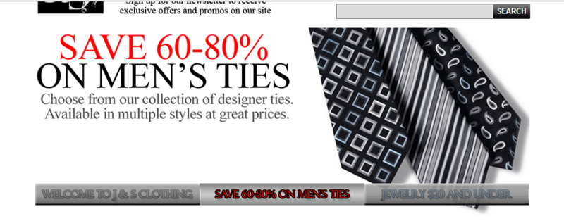

JANDSCLOTHINGCO Posted August 2, 2013 Share Posted August 2, 2013 I was looking for the same thing. I accompished it without much coding, but had to make two images files. One for the overall pager background with the text on it and one for the active pager overlay to distinguish the active slide. You can see it in action at my site www.jandsclothingco.com I am using 1.5.4.1 but it should be the same for different versions since it is not much coding. Link to comment Share on other sites More sharing options...

vekia Posted August 3, 2013 Share Posted August 3, 2013 @JANDSCLOTHINGCO it looks very nice, i just wondering how to append simple html + css code insted the picture (especially for different language versions) Link to comment Share on other sites More sharing options...
