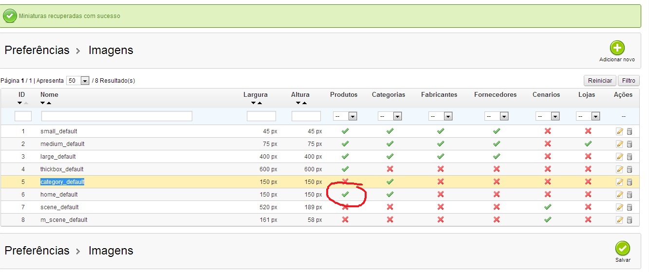

Česká Faktura Posted October 4, 2012 Share Posted October 4, 2012 Hi , the problem is that after the upgrade the old image file system does not work and the new is used even you select the old in the preferences->Images 1 Link to comment Share on other sites More sharing options...
Česká Faktura Posted October 4, 2012 Share Posted October 4, 2012 SOLVED I changed the image file system,move the images, regenerated the thumbs, cleared smarty cache and now it is working. 1 Link to comment Share on other sites More sharing options...

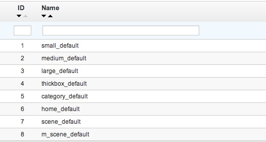

ajensen27 Posted October 4, 2012 Author Share Posted October 4, 2012 Thank you Ventos... Can you please explain the method you used to change the file system, move the images, and regenerate the thumbs? Link to comment Share on other sites More sharing options...
ajensen27 Posted October 5, 2012 Author Share Posted October 5, 2012 Ok I figured out how to move the images and regenerate the thumbs on the backend, but that didn't do anything... What do you mean by changing the file system? Link to comment Share on other sites More sharing options...
ajensen27 Posted October 5, 2012 Author Share Posted October 5, 2012 Oh and how do you clear the smarty cache? Link to comment Share on other sites More sharing options...
Česká Faktura Posted October 5, 2012 Share Posted October 5, 2012 to change the file system - Preferences > Images > Use the legacy image filesystem - NO clear the smarty cache - go to cache/smarty and delete files in both folders (do not delete index.php) 1 Link to comment Share on other sites More sharing options...

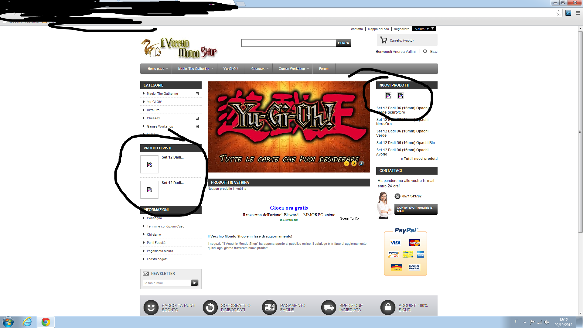

Vallo92 Posted October 5, 2012 Share Posted October 5, 2012 Hi, I also have this problem and I can not solve it! : ( Could you describe step by step what should I do? Thank you! Link to comment Share on other sites More sharing options...

doubleD Posted October 5, 2012 Share Posted October 5, 2012 Does not work What is your image url? Copy and paste image URL from browser, may be it will help... 1 Link to comment Share on other sites More sharing options...
Vallo92 Posted October 5, 2012 Share Posted October 5, 2012 http://ilvecchiomondoshop.it/27-large/ajani-evocatore-del-branco.jpg Link to comment Share on other sites More sharing options...
doubleD Posted October 5, 2012 Share Posted October 5, 2012 http://ilvecchiomond...-del-branco.jpg Did you move images to the new FS? Mine looks like site/1-267-large_default/300v-high-rpm.jpg I do not see _default link in your url... Maybe you have a different problem... 1 Link to comment Share on other sites More sharing options...
Vallo92 Posted October 5, 2012 Share Posted October 5, 2012 (edited) I just tried but does not work too ... However, in all the names _defoult was already present after the upgrade. Did you move images to the new FS? Can you explain this better? Edited October 5, 2012 by Vallo92 (see edit history) Link to comment Share on other sites More sharing options...

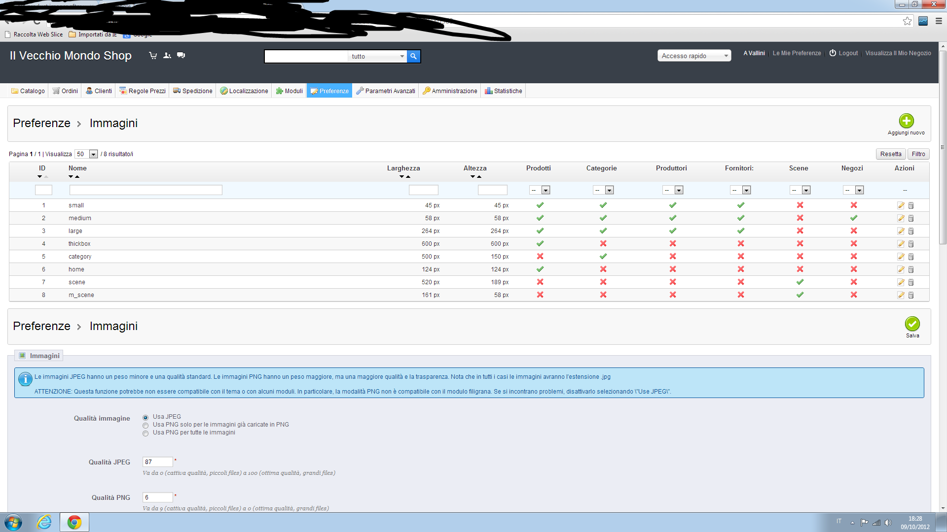

Vallo92 Posted October 9, 2012 Share Posted October 9, 2012 Here's a screen: Link to comment Share on other sites More sharing options...
doubleD Posted October 9, 2012 Share Posted October 9, 2012 Here's a screen: Ok, now copy the link to the non-displayed image and see what it says there... It should link to small or small_default (or medium or medium_default) ? Link to comment Share on other sites More sharing options...
Vallo92 Posted October 9, 2012 Share Posted October 9, 2012 Mmmmmm, I tried to see the link of the image and connects to "medium_default" (http://ilvecchiomondoshop.it/269-medium_default/set-12-dadi-d6-16mm-opachi-verde-scurooro.jpg)! How do I fix this? Link to comment Share on other sites More sharing options...
doubleD Posted October 9, 2012 Share Posted October 9, 2012 (edited) Mmmmmm, I tried to see the link of the image and connects to "medium_default" (http://ilvecchiomond...de-scurooro.jpg)! How do I fix this? Well, there are a few ways ) The first option is to rename image type 'medium' to medium_default The second option is to duplicate medium image type and name it medium_default... The third option is what bside2234 suggested here-post 35 (Same problem as you have) Nothing else comes to my mind right now... Edited October 9, 2012 by doubleD (see edit history) Link to comment Share on other sites More sharing options...
doubleD Posted October 9, 2012 Share Posted October 9, 2012 (edited) Mmmmmm, I tried to see the link of the image and connects to "medium_default" (http://ilvecchiomond...de-scurooro.jpg)! How do I fix this? That's a very strange issue, cause my configuration works fine for all image types with _default names and doesn't work without _default.... Edited October 9, 2012 by doubleD (see edit history) Link to comment Share on other sites More sharing options...

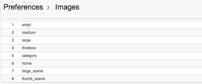

ajensen27 Posted October 9, 2012 Author Share Posted October 9, 2012 I just created duplicate Image types (i.e. small & small_default, home & home_default, etc.), recreated the thumbs, and now every image on my site is working again. I would give this method a try until PS has a bug fix in the next version. Link to comment Share on other sites More sharing options...
bside2234 Posted October 9, 2012 Share Posted October 9, 2012 Do you use ps 1.5 default theme or updating shop with your previous theme? The thing is: In prestashop 1.5.0.17 product-list.tpl file <img src="{$link->getImageLink($product.link_rewrite, $product.id_image, 'home')}" and prestashop 1.5.1 <img src="{$link->getImageLink($product.link_rewrite, $product.id_image, 'home_default')}" That explains a lot I'm using the default theme. I'll have a look at that. Here is my site just for reference: http://griffineffects.com/store Link to comment Share on other sites More sharing options...
bside2234 Posted October 9, 2012 Share Posted October 9, 2012 I just created duplicate Image types (i.e. small & small_default, home & home_default, etc.), recreated the thumbs, and now every image on my site is working again. I would give this method a try until PS has a bug fix in the next version. Sweet. I'll try this. I have to say at this point I'm afraid to mess with it at all though. I have 99% of images working. Link to comment Share on other sites More sharing options...
benjamin utterback Posted October 9, 2012 Share Posted October 9, 2012 Hello bside, you can always create and confirm a working backup if you would like to tinker around a little bit Link to comment Share on other sites More sharing options...
doubleD Posted October 9, 2012 Share Posted October 9, 2012 Sweet. I'll try this. I have to say at this point I'm afraid to mess with it at all though. I have 99% of images working. The only ptoblem is twice img folder size ))) But it works Link to comment Share on other sites More sharing options...
bside2234 Posted October 9, 2012 Share Posted October 9, 2012 Hello bside, you can always create and confirm a working backup if you would like to tinker around a little bit Yeah, I plan on backing it up. I also have a test site it try stuff out on too but that one has really been messed up due to the 1.5.1 update I did to it. I'll probably have to try and fix it first. Link to comment Share on other sites More sharing options...
benjamin utterback Posted October 9, 2012 Share Posted October 9, 2012 Hi bside, yes I think that is a great idea. It's not good to see a user not back up their store and attempt to upgrade to a newer version. Link to comment Share on other sites More sharing options...
bside2234 Posted October 9, 2012 Share Posted October 9, 2012 Well, I confirm that creating the duplicates of each does work. I didn't regenerate thumbnails though. Just created duplicates and refreshed all my browser windows and all the images showed up. Nice!!! 1 Link to comment Share on other sites More sharing options...

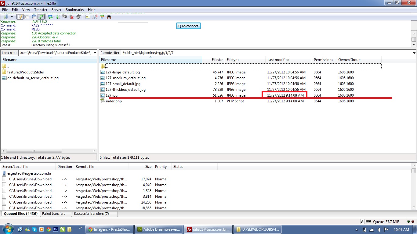

b.designer Posted November 27, 2012 Share Posted November 27, 2012 man, i can not get the images to be shown on home (featured) and category... i have _default and have regenerate, still, i see no images... www.tissu.com.br/lojaonline please, heeeeeelp... tks. Link to comment Share on other sites More sharing options...
doubleD Posted November 27, 2012 Share Posted November 27, 2012 (edited) man, i can not get the images to be shown on home (featured) and category... i have _default and have regenerate, still, i see no images... www.tissu.com.br/lojaonline please, heeeeeelp... tks. There is no image http://www.tissu.com.br/lojaonline/img/p/1/1/2/112-home_default.jpg What about img folder permissions (775 777) ? Are you sure the images regenerated successfully? Edited November 27, 2012 by doubleD (see edit history) Link to comment Share on other sites More sharing options...
b.designer Posted November 27, 2012 Share Posted November 27, 2012 (edited) There is no image http://www.tissu.com.br/lojaonline/img/p/1/1/2/112-home_default.jpg What about img folder permissions (775 777) ? Are you sure the images regenerated successfully? Hey, you are right, the images arent there, but why arent the images there? I did regenerated and nothing happens... As for the permision, all the folders inside img have the same permission... 755 Dont know what to do... any idea? Tks... Edited November 27, 2012 by b.designer (see edit history) Link to comment Share on other sites More sharing options...
doubleD Posted November 27, 2012 Share Posted November 27, 2012 Hey, you are right, the images arent there, but why arent the images there? I did regenerated and nothing happens... As for the permision, all the folders inside img have the same permission... 755 Dont know what to do... any idea? Tks... The permission for the images should be 777 as prestashop suggests, mine are 775. 755 is not enough i guess Try to set permission recursive 777 to img.... regenerate the images, then you can change them back as you need. Link to comment Share on other sites More sharing options...
b.designer Posted November 27, 2012 Share Posted November 27, 2012 The permission for the images should be 777 as prestashop suggests, mine are 775. 755 is not enough i guess Try to set permission recursive 777 to img.... regenerate the images, then you can change them back as you need. just done that! nothing changed, the images were not even created inside the folders... i can not understand this thing happening, cos all the images were just working fineeeee... oh gosh... Link to comment Share on other sites More sharing options...
doubleD Posted November 27, 2012 Share Posted November 27, 2012 just done that! nothing changed, the images were not even created inside the folders... i can not understand this thing happening, cos all the images were just working fineeeee... oh gosh... .it happens ) For the quick fix you can edit product-list.tpl file. Find the line <img src="{$link->getImageLink($product.link_rewrite, $product.id_image, 'home_default')}" Remove _default so it will look like this <img src="{$link->getImageLink($product.link_rewrite, $product.id_image, 'home')}" The same for the featured module... To regenerate images i suggest you to install prestashop on your localhost, regenerate them and then upload to the server. I think that's more likely a hosting issue not prestashop, though... Link to comment Share on other sites More sharing options...
b.designer Posted November 27, 2012 Share Posted November 27, 2012 .it happens ) For the quick fix you can edit product-list.tpl file. Find the line <img src="{$link->getImageLink($product.link_rewrite, $product.id_image, 'home_default')}" Remove _default so it will look like this <img src="{$link->getImageLink($product.link_rewrite, $product.id_image, 'home')}" The same for the featured module... To regenerate images i suggest you to install prestashop on your localhost, regenerate them and then upload to the server. I think that's more likely a hosting issue not prestashop, though... i tried removing _default, still nothing happens. i didn't try installing locally tho. hey, have a look, please, at what i found out. when i try to regenerate there are some files that do not regenerate. please, see attach... the ones that were regenerated have the same time, except for one. what could that be? tks. Link to comment Share on other sites More sharing options...
doubleD Posted November 27, 2012 Share Posted November 27, 2012 (edited) i tried removing _default, still nothing happens. i didn't try installing locally tho. hey, have a look, please, at what i found out. when i try to regenerate there are some files that do not regenerate. please, see attach... the ones that were regenerated have the same time, except for one. what could that be? tks. 127.jpg is the main image from which all other are generated, so it's ok. But, i can see the images were regenerated... i mean the names are with _default... and there is no home_default... are you sure you have home_default type set up in prestashop? Here are the image types: 1 small_default 2 medium_default 3 large_default 4 thickbox_default 5 category_default 6 home_default 7 scene_default 8 m_scene_default Edited November 27, 2012 by doubleD (see edit history) 1 Link to comment Share on other sites More sharing options...
b.designer Posted November 27, 2012 Share Posted November 27, 2012 127.jpg is the main image from which all other are generated, so it's ok. But, i can see the images were regenerated... i mean the names are with _default... and there is no home_default... are you sure you have home_default type set up in prestashop? Here are the image types: 1 small_default 2 medium_default 3 large_default 4 thickbox_default 5 category_default 6 home_default 7 scene_default 8 m_scene_default Hey! Thank you very much for helping me! You guys rock! What happened was that I do have all these types of images, thou i had not ticked "products" in the home_default type. Now all is fine! Tks again! What an idiot I am... :-) Link to comment Share on other sites More sharing options...
