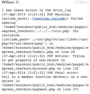

srtk Posted April 8, 2014 Share Posted April 8, 2014 Hi, thank you. I have talked to my host and they tell me they see the following fatal errors in the log : what should i do ? Link to comment Share on other sites More sharing options...
liviaboutique Posted April 8, 2014 Share Posted April 8, 2014 Hi, thank you. I have talked to my host and they tell me they see the following fatal errors in the log : what should i do ? Hi you can send that to paypal technical support and they should help you.Thanks Link to comment Share on other sites More sharing options...
