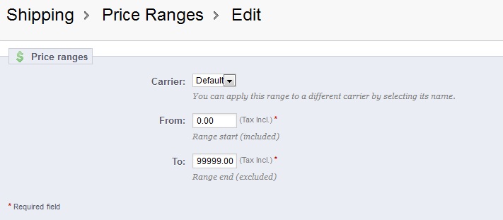

benjamin utterback Posted November 13, 2012 Share Posted November 13, 2012 Hello all, and thank you for the solution. Please make sure that you input a price range and weight range for each carrier, even if you shipping the items yourself. The ranges need to be put in order for the Carrier to become available. I will go ahead and mark this thread as solved. Thank you for choosing PrestaShop! 1 Link to comment Share on other sites More sharing options...

hostricity Posted April 25, 2013 Share Posted April 25, 2013 (edited) I had this problem trying to setup USPS and UPS. Here's what I did to fix it: 1. Reset the USPS and UPS modules. 2. Set them up again with my account info, api key, etc. NOW: Here's the important part: Do NOT setup Price Ranges or Weight Ranges at this point. The default ranges are universal. Do NOT setup shipping for individual products or categories. The defaults are universal. Verify that you can see the shipping options for your chosen carriers in the check out. The Shipping Estimator module is handy in this regard because it allows you to easily test shipping addresses and products in cart to see that it is working. If you cannot see the various shipping options, make sure that you have shipping options selected that are compatible with the dimensions, weight, and packaging you have set for the carrier, shipping methods and the products. NOW: Once you have successfully gotten the carriers and shipping methods working (displaying, calculating, etc.), you can setup Price Ranges, Weight Ranges, specific shipping types for individual products or categories, limit which countries can use which shipping method, etc. WHY: The Price Ranges, Weight Ranges, and shipping options for individual categories and products are used to LIMIT the shipping options to make them more accurate. (You can't ship a 40 lb television in a USPS Flat Rate Box!) LESSON: If you choose incompatible options, your carrier and shipping methods will not display or calculate. So, get the SIMPLEST possible configuration for each carrier working and then set the options that limit the carriers and methods. Edited April 25, 2013 by hostricity (see edit history) Link to comment Share on other sites More sharing options...

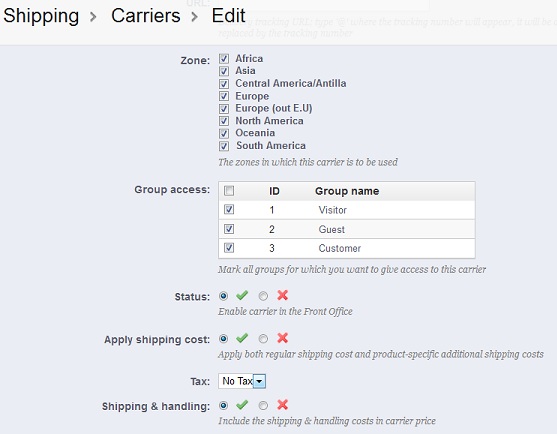

entrancey Posted November 18, 2013 Share Posted November 18, 2013 (edited) I've had a the same problem upon check out via Instant Checkout. what you need to do is set the carrier group access to check the guest and visitor option. Step by step solutions : http://www.unblockwww.com/solved/prestashop-error-there-are-no-carriers-that-deliver-to-the-address-you-selected/ thanks Edited November 18, 2013 by entrancey (see edit history) Link to comment Share on other sites More sharing options...

nikabstore Posted July 17, 2017 Share Posted July 17, 2017 After spending sometime, finally I figured out the exact issue. The problem was with carries configuration. Go to shipping >carries then select the carrier and click on 'edit'. Then select on tab 'shipping location and costs' , and then select the proper region of your country and save it. Best regards, Tanveer Link to comment Share on other sites More sharing options...

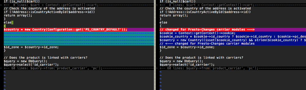

kirubanidhi Posted July 19, 2017 Share Posted July 19, 2017 (edited) I am migrated prestashop version 1.5.6 to 1.6.1.15. In older version prestashop 1.5.6. I saw classes/carrier.php file inside getAvailableCarrierList() method then check module/ups/overrride_1.5/classes/carrier.php file inside i found same method such as getAvailableCarrierList(). Both getAvailableCarrierList() coding is same so any error message does not appear. Ex: prestashop/Classes/Carrier.php public static function getAvailableCarrierList(Product $product, $id_warehouse, $id_address_delivery = null, $id_shop = null, $cart = null) { if (is_null($id_shop)) $id_shop = Context::getContext()->shop->id; if (is_null($cart)) $cart = Context::getContext()->cart; $id_address = (int)((!is_null($id_address_delivery) && $id_address_delivery != 0) ? $id_address_delivery : $cart->id_address_delivery); if ($id_address) { $address = new Address($id_address); $id_zone = Address::getZoneById($address->id); // Check the country of the address is activated if (!Address::isCountryActiveById($address->id)) return array(); } else { $country = new Country(Configuration::get('PS_COUNTRY_DEFAULT')); $id_zone = $country->id_zone; } // Does the product is linked with carriers? $query = new DbQuery(); $query->select('id_carrier'); $query->from('product_carrier', 'pc'); $query->innerJoin('carrier', 'c', 'c.id_reference = pc.id_carrier_reference AND c.deleted = 0'); $query->where('pc.id_product = '.(int)$product->id); $query->where('pc.id_shop = '.(int)$id_shop); $cache_id = 'Carrier::getAvailableCarrierList_'.(int)$product->id.'-'.(int)$id_shop; if (!Cache::isStored($cache_id)) { $carriers_for_product = Db::getInstance(_PS_USE_SQL_SLAVE_)->executeS($query); Cache::store($cache_id, $carriers_for_product); } $carriers_for_product = Cache::retrieve($cache_id); $carrier_list = array(); if (!empty($carriers_for_product)) { //the product is linked with carriers foreach ($carriers_for_product as $carrier) //check if the linked carriers are available in current zone if (Carrier::checkCarrierZone($carrier['id_carrier'], $id_zone)) $carrier_list[] = $carrier['id_carrier']; if (empty($carrier_list)) return array();//no linked carrier are available for this zone } // The product is not dirrectly linked with a carrier // Get all the carriers linked to a warehouse if ($id_warehouse) { $warehouse = new Warehouse($id_warehouse); $warehouse_carrier_list = $warehouse->getCarriers(); } $available_carrier_list = array(); $customer = new Customer($cart->id_customer); $carriers = Carrier::getCarriersForOrder($id_zone, $customer->getGroups(), $cart); foreach ($carriers as $carrier) $available_carrier_list[] = $carrier['id_carrier']; if ($carrier_list) $carrier_list = array_intersect($available_carrier_list, $carrier_list); else $carrier_list = $available_carrier_list; if (isset($warehouse_carrier_list)) $carrier_list = array_intersect($carrier_list, $warehouse_carrier_list); if ($product->width > 0 || $product->height > 0 || $product->depth > 0 || $product->weight > 0) { foreach ($carrier_list as $key => $id_carrier) { $carrier = new Carrier($id_carrier); if (($carrier->max_width > 0 && $carrier->max_width < $product->width) || ($carrier->max_height > 0 && $carrier->max_height < $product->height) || ($carrier->max_depth > 0 && $carrier->max_depth < $product->depth) || ($carrier->max_weight > 0 && $carrier->max_weight < $product->weight)) unset($carrier_list[$key]); } } return $carrier_list; } prestashop/modules/ups/override_1.5/classes/Carrier.php public static function getAvailableCarrierList(Product $product, $id_warehouse, $id_address_delivery = null, $id_shop = null, $cart = null) { if (is_null($id_shop)) $id_shop = Context::getContext()->shop->id; if (is_null($cart)) $cart = Context::getContext()->cart; $id_address = (int)((!is_null($id_address_delivery) && $id_address_delivery != 0) ? $id_address_delivery : $cart->id_address_delivery); if ($id_address) { $address = new Address($id_address); $id_zone = Address::getZoneById($address->id); // Check the country of the address is activated if (!Address::isCountryActiveById($address->id)) return array(); } else { // changed for Presto-Changeo carrier modules ---> $cookie = Context::getContext()->cookie; $cookie_country = $cookie->id_country ? $cookie->id_country : $cookie->pc_dest_country; $country = new Country((isset($cookie_country) && strlen($cookie_country) ? $cookie_country : Configuration::get('PS_COUNTRY_DEFAULT'))); // <--- changed for Presto-Changeo carrier modules $id_zone = $country->id_zone; } // Does the product is linked with carriers? $query = new DbQuery(); $query->select('id_carrier'); $query->from('product_carrier', 'pc'); $query->innerJoin('carrier', 'c', 'c.id_reference = pc.id_carrier_reference AND c.deleted = 0'); $query->where('pc.id_product = '.(int)$product->id); $query->where('pc.id_shop = '.(int)$id_shop); $cache_id = 'Carrier::getAvailableCarrierList_'.(int)$product->id.'-'.(int)$id_shop; if (!Cache::isStored($cache_id)) { $carriers_for_product = Db::getInstance(_PS_USE_SQL_SLAVE_)->executeS($query); Cache::store($cache_id, $carriers_for_product); } $carriers_for_product = Cache::retrieve($cache_id); $carrier_list = array(); if (!empty($carriers_for_product)) { //the product is linked with carriers foreach ($carriers_for_product as $carrier) //check if the linked carriers are available in current zone if (Carrier::checkCarrierZone($carrier['id_carrier'], $id_zone)) $carrier_list[] = $carrier['id_carrier']; if (empty($carrier_list)) return array();//no linked carrier are available for this zone } // The product is not dirrectly linked with a carrier // Get all the carriers linked to a warehouse if ($id_warehouse) { $warehouse = new Warehouse($id_warehouse); $warehouse_carrier_list = $warehouse->getCarriers(); } $available_carrier_list = array(); $customer = new Customer($cart->id_customer); $carriers = Carrier::getCarriersForOrder($id_zone, $customer->getGroups(), $cart); foreach ($carriers as $carrier) $available_carrier_list[] = $carrier['id_carrier']; if ($carrier_list) $carrier_list = array_intersect($available_carrier_list, $carrier_list); else $carrier_list = $available_carrier_list; if (isset($warehouse_carrier_list)) $carrier_list = array_intersect($carrier_list, $warehouse_carrier_list); if ($product->width > 0 || $product->height > 0 || $product->depth > 0 || $product->weight > 0) { foreach ($carrier_list as $key => $id_carrier) { $carrier = new Carrier($id_carrier); if (($carrier->max_width > 0 && $carrier->max_width < $product->width) || ($carrier->max_height > 0 && $carrier->max_height < $product->height) || ($carrier->max_depth > 0 && $carrier->max_depth < $product->depth) || ($carrier->max_weight > 0 && $carrier->max_weight < $product->weight)) unset($carrier_list[$key]); } } return $carrier_list; } } -------------------------------------------------------------------------------------------------------------------------------------------------------------------- Now i am checking prestashop version 1.6.1.15 I saw classes/carrier.php file inside getAvailableCarrierList() method then check module/ups/overrride_1.6/classes/carrier.php file inside i found same method such as getAvailableCarrierList(). Both getAvailableCarrierList() coding are different. How to resolve it. Ex: Classes/Carrier.php: public static function getAvailableCarrierList(Product $product, $id_warehouse, $id_address_delivery = null, $id_shop = null, $cart = null, &$error = array()) { static $ps_country_default = null; if ($ps_country_default === null) { $ps_country_default = Configuration::get('PS_COUNTRY_DEFAULT'); } if (is_null($id_shop)) { $id_shop = Context::getContext()->shop->id; } if (is_null($cart)) { $cart = Context::getContext()->cart; } if (is_null($error) || !is_array($error)) { $error = array(); } $id_address = (int)((!is_null($id_address_delivery) && $id_address_delivery != 0) ? $id_address_delivery : $cart->id_address_delivery); if ($id_address) { $id_zone = Address::getZoneById($id_address); // Check the country of the address is activated if (!Address::isCountryActiveById($id_address)) { return array(); } } else { $country = new Country($ps_country_default); $id_zone = $country->id_zone; } // Does the product is linked with carriers? $cache_id = 'Carrier::getAvailableCarrierList_'.(int)$product->id.'-'.(int)$id_shop; if (!Cache::isStored($cache_id)) { $query = new DbQuery(); $query->select('id_carrier'); $query->from('product_carrier', 'pc'); $query->innerJoin( 'carrier', 'c', 'c.id_reference = pc.id_carrier_reference AND c.deleted = 0 AND c.active = 1' ); $query->where('pc.id_product = '.(int)$product->id); $query->where('pc.id_shop = '.(int)$id_shop); $carriers_for_product = Db::getInstance(_PS_USE_SQL_SLAVE_)->executeS($query); Cache::store($cache_id, $carriers_for_product); } else { $carriers_for_product = Cache::retrieve($cache_id); } $carrier_list = array(); if (!empty($carriers_for_product)) { //the product is linked with carriers foreach ($carriers_for_product as $carrier) { //check if the linked carriers are available in current zone if (Carrier::checkCarrierZone($carrier['id_carrier'], $id_zone)) { $carrier_list[$carrier['id_carrier']] = $carrier['id_carrier']; } } if (empty($carrier_list)) { return array(); }//no linked carrier are available for this zone } // The product is not dirrectly linked with a carrier // Get all the carriers linked to a warehouse if ($id_warehouse) { $warehouse = new Warehouse($id_warehouse); $warehouse_carrier_list = $warehouse->getCarriers(); } $available_carrier_list = array(); $cache_id = 'Carrier::getAvailableCarrierList_getCarriersForOrder_'.(int)$id_zone.'-'.(int)$cart->id; if (!Cache::isStored($cache_id)) { $customer = new Customer($cart->id_customer); $carrier_error = array(); $carriers = Carrier::getCarriersForOrder($id_zone, $customer->getGroups(), $cart, $carrier_error); Cache::store($cache_id, array($carriers, $carrier_error)); } else { list($carriers, $carrier_error) = Cache::retrieve($cache_id); } $error = array_merge($error, $carrier_error); foreach ($carriers as $carrier) { $available_carrier_list[$carrier['id_carrier']] = $carrier['id_carrier']; } if ($carrier_list) { $carrier_list = array_intersect($available_carrier_list, $carrier_list); } else { $carrier_list = $available_carrier_list; } if (isset($warehouse_carrier_list)) { $carrier_list = array_intersect($carrier_list, $warehouse_carrier_list); } $cart_quantity = 0; $cart_weight = 0; foreach ($cart->getProducts(false, false) as $cart_product) { if ($cart_product['id_product'] == $product->id) { $cart_quantity += $cart_product['cart_quantity']; } if (isset($cart_product['weight_attribute']) && $cart_product['weight_attribute'] > 0) { $cart_weight += ($cart_product['weight_attribute'] * $cart_product['cart_quantity']); } else { $cart_weight += ($cart_product['weight'] * $cart_product['cart_quantity']); } } if ($product->width > 0 || $product->height > 0 || $product->depth > 0 || $product->weight > 0 || $cart_weight > 0) { foreach ($carrier_list as $key => $id_carrier) { $carrier = new Carrier($id_carrier); // Get the sizes of the carrier and the product and sort them to check if the carrier can take the product. $carrier_sizes = array((int)$carrier->max_width, (int)$carrier->max_height, (int)$carrier->max_depth); $product_sizes = array((int)$product->width, (int)$product->height, (int)$product->depth); rsort($carrier_sizes, SORT_NUMERIC); rsort($product_sizes, SORT_NUMERIC); if (($carrier_sizes[0] > 0 && $carrier_sizes[0] < $product_sizes[0]) || ($carrier_sizes[1] > 0 && $carrier_sizes[1] < $product_sizes[1]) || ($carrier_sizes[2] > 0 && $carrier_sizes[2] < $product_sizes[2])) { $error[$carrier->id] = Carrier::SHIPPING_SIZE_EXCEPTION; unset($carrier_list[$key]); } if ($carrier->max_weight > 0 && ($carrier->max_weight < $product->weight * $cart_quantity || $carrier->max_weight < $cart_weight)) { $error[$carrier->id] = Carrier::SHIPPING_WEIGHT_EXCEPTION; unset($carrier_list[$key]); } } } return $carrier_list; } modules/ups/override_1.6/classes/Carrier.php: public static function getAvailableCarrierList(Product $product, $id_warehouse, $id_address_delivery = null, $id_shop = null, $cart = null) { if (is_null($id_shop)) $id_shop = Context::getContext()->shop->id; if (is_null($cart)) $cart = Context::getContext()->cart; $id_address = (int)((!is_null($id_address_delivery) && $id_address_delivery != 0) ? $id_address_delivery : $cart->id_address_delivery); if ($id_address) { $address = new Address($id_address); $id_zone = Address::getZoneById($address->id); // Check the country of the address is activated if (!Address::isCountryActiveById($address->id)) return array(); } else { // changed for Presto-Changeo carrier modules ---> $cookie = Context::getContext()->cookie; $cookie_country = $cookie->id_country ? $cookie->id_country : $cookie->pc_dest_country; $country = new Country((isset($cookie_country) && strlen($cookie_country) ? $cookie_country : Configuration::get('PS_COUNTRY_DEFAULT'))); // <--- changed for Presto-Changeo carrier modules $id_zone = $country->id_zone; } // Does the product is linked with carriers? $query = new DbQuery(); $query->select('id_carrier'); $query->from('product_carrier', 'pc'); $query->innerJoin('carrier', 'c', 'c.id_reference = pc.id_carrier_reference AND c.deleted = 0'); $query->where('pc.id_product = '.(int)$product->id); $query->where('pc.id_shop = '.(int)$id_shop); $cache_id = 'Carrier::getAvailableCarrierList_'.(int)$product->id.'-'.(int)$id_shop; if (!Cache::isStored($cache_id)) { $carriers_for_product = Db::getInstance(_PS_USE_SQL_SLAVE_)->executeS($query); Cache::store($cache_id, $carriers_for_product); } $carriers_for_product = Cache::retrieve($cache_id); $carrier_list = array(); if (!empty($carriers_for_product)) { //the product is linked with carriers foreach ($carriers_for_product as $carrier) //check if the linked carriers are available in current zone if (Carrier::checkCarrierZone($carrier['id_carrier'], $id_zone)) $carrier_list[] = $carrier['id_carrier']; if (empty($carrier_list)) return array();//no linked carrier are available for this zone } // The product is not dirrectly linked with a carrier // Get all the carriers linked to a warehouse if ($id_warehouse) { $warehouse = new Warehouse($id_warehouse); $warehouse_carrier_list = $warehouse->getCarriers(); } $available_carrier_list = array(); $customer = new Customer($cart->id_customer); $carriers = Carrier::getCarriersForOrder($id_zone, $customer->getGroups(), $cart); foreach ($carriers as $carrier) $available_carrier_list[] = $carrier['id_carrier']; if ($carrier_list) $carrier_list = array_intersect($available_carrier_list, $carrier_list); else $carrier_list = $available_carrier_list; if (isset($warehouse_carrier_list)) $carrier_list = array_intersect($carrier_list, $warehouse_carrier_list); if ($product->width > 0 || $product->height > 0 || $product->depth > 0 || $product->weight > 0) { foreach ($carrier_list as $key => $id_carrier) { $carrier = new Carrier($id_carrier); if (($carrier->max_width > 0 && $carrier->max_width < $product->width) || ($carrier->max_height > 0 && $carrier->max_height < $product->height) || ($carrier->max_depth > 0 && $carrier->max_depth < $product->depth) || ($carrier->max_weight > 0 && $carrier->max_weight < $product->weight)) unset($carrier_list[$key]); } } return $carrier_list; } Edited July 20, 2017 by kirubanidhi (see edit history) Link to comment Share on other sites More sharing options...
kirubanidhi Posted July 20, 2017 Share Posted July 20, 2017 (edited) In older version prestashop 1.5.6. I saw classes/carrier.php file inside getAvailableCarrierList() method then check module/ups/overrride_1.5/classes/carrier.php file inside i found same method such as getAvailableCarrierList(). Both getAvailableCarrierList() method and their arguments are same. Now i am checking prestashop version 1.6.1.15. I saw classes/carrier.php file inside getAvailableCarrierList() method then check module/ups/overrride_1.6/classes/carrier.php file inside i found same method such as getAvailableCarrierList(). Both getAvailableCarrierList() method and their arguments are different. Please give me correct solution of this problem. Edited July 20, 2017 by kirubanidhi (see edit history) Link to comment Share on other sites More sharing options...
DataKick Posted July 20, 2017 Share Posted July 20, 2017 (edited) In older version prestashop 1.5.6. I saw classes/carrier.php file inside getAvailableCarrierList() method then check module/ups/overrride_1.5/classes/carrier.php file inside i found same method such as getAvailableCarrierList(). Both getAvailableCarrierList() coding is same so any error message does not appear. Well, we have 4 versions of the method here. First, let's compare 1.5 core version with 1.5 override version: There are three new lines here. These lines are the reason why this override exists. Now, let's compare overrides between 1.5 and 1.6 versions. Surprisingly, the content is same. Even though code in 1.6 version has changed. I suggest this - copy code from 1.6 version to override, and manually insert those few lines in the right place. The result will look like this (I haven't tested it, though) // core 1.6 public static function getAvailableCarrierList(Product $product, $id_warehouse, $id_address_delivery = null, $id_shop = null, $cart = null, &$error = array()) { static $ps_country_default = null; if ($ps_country_default === null) { $ps_country_default = Configuration::get('PS_COUNTRY_DEFAULT'); } if (is_null($id_shop)) { $id_shop = Context::getContext()->shop->id; } if (is_null($cart)) { $cart = Context::getContext()->cart; } if (is_null($error) || !is_array($error)) { $error = array(); } $id_address = (int)((!is_null($id_address_delivery) && $id_address_delivery != 0) ? $id_address_delivery : $cart->id_address_delivery); if ($id_address) { $id_zone = Address::getZoneById($id_address); // Check the country of the address is activated if (!Address::isCountryActiveById($id_address)) { return array(); } } else { // ******************************* changed for Presto-Changeo carrier modules ---> $cookie = Context::getContext()->cookie; $cookie_country = $cookie->id_country ? $cookie->id_country : $cookie->pc_dest_country; $country = new Country((isset($cookie_country) && strlen($cookie_country) ? $cookie_country : $ps_country_default)); // ******************************* <--- changed for Presto-Changeo carrier modules $id_zone = $country->id_zone; } // Does the product is linked with carriers? $cache_id = 'Carrier::getAvailableCarrierList_'.(int)$product->id.'-'.(int)$id_shop; if (!Cache::isStored($cache_id)) { $query = new DbQuery(); $query->select('id_carrier'); $query->from('product_carrier', 'pc'); $query->innerJoin( 'carrier', 'c', 'c.id_reference = pc.id_carrier_reference AND c.deleted = 0 AND c.active = 1' ); $query->where('pc.id_product = '.(int)$product->id); $query->where('pc.id_shop = '.(int)$id_shop); $carriers_for_product = Db::getInstance(_PS_USE_SQL_SLAVE_)->executeS($query); Cache::store($cache_id, $carriers_for_product); } else { $carriers_for_product = Cache::retrieve($cache_id); } $carrier_list = array(); if (!empty($carriers_for_product)) { //the product is linked with carriers foreach ($carriers_for_product as $carrier) { //check if the linked carriers are available in current zone if (Carrier::checkCarrierZone($carrier['id_carrier'], $id_zone)) { $carrier_list[$carrier['id_carrier']] = $carrier['id_carrier']; } } if (empty($carrier_list)) { return array(); }//no linked carrier are available for this zone } // The product is not dirrectly linked with a carrier // Get all the carriers linked to a warehouse if ($id_warehouse) { $warehouse = new Warehouse($id_warehouse); $warehouse_carrier_list = $warehouse->getCarriers(); } $available_carrier_list = array(); $cache_id = 'Carrier::getAvailableCarrierList_getCarriersForOrder_'.(int)$id_zone.'-'.(int)$cart->id; if (!Cache::isStored($cache_id)) { $customer = new Customer($cart->id_customer); $carrier_error = array(); $carriers = Carrier::getCarriersForOrder($id_zone, $customer->getGroups(), $cart, $carrier_error); Cache::store($cache_id, array($carriers, $carrier_error)); } else { list($carriers, $carrier_error) = Cache::retrieve($cache_id); } $error = array_merge($error, $carrier_error); foreach ($carriers as $carrier) { $available_carrier_list[$carrier['id_carrier']] = $carrier['id_carrier']; } if ($carrier_list) { $carrier_list = array_intersect($available_carrier_list, $carrier_list); } else { $carrier_list = $available_carrier_list; } if (isset($warehouse_carrier_list)) { $carrier_list = array_intersect($carrier_list, $warehouse_carrier_list); } $cart_quantity = 0; $cart_weight = 0; foreach ($cart->getProducts(false, false) as $cart_product) { if ($cart_product['id_product'] == $product->id) { $cart_quantity += $cart_product['cart_quantity']; } if (isset($cart_product['weight_attribute']) && $cart_product['weight_attribute'] > 0) { $cart_weight += ($cart_product['weight_attribute'] * $cart_product['cart_quantity']); } else { $cart_weight += ($cart_product['weight'] * $cart_product['cart_quantity']); } } if ($product->width > 0 || $product->height > 0 || $product->depth > 0 || $product->weight > 0 || $cart_weight > 0) { foreach ($carrier_list as $key => $id_carrier) { $carrier = new Carrier($id_carrier); // Get the sizes of the carrier and the product and sort them to check if the carrier can take the product. $carrier_sizes = array((int)$carrier->max_width, (int)$carrier->max_height, (int)$carrier->max_depth); $product_sizes = array((int)$product->width, (int)$product->height, (int)$product->depth); rsort($carrier_sizes, SORT_NUMERIC); rsort($product_sizes, SORT_NUMERIC); if (($carrier_sizes[0] > 0 && $carrier_sizes[0] < $product_sizes[0]) || ($carrier_sizes[1] > 0 && $carrier_sizes[1] < $product_sizes[1]) || ($carrier_sizes[2] > 0 && $carrier_sizes[2] < $product_sizes[2])) { $error[$carrier->id] = Carrier::SHIPPING_SIZE_EXCEPTION; unset($carrier_list[$key]); } if ($carrier->max_weight > 0 && ($carrier->max_weight < $product->weight * $cart_quantity || $carrier->max_weight < $cart_weight)) { $error[$carrier->id] = Carrier::SHIPPING_WEIGHT_EXCEPTION; unset($carrier_list[$key]); } } } return $carrier_list; } This should have been fixed by module creator, btw. Good luck Edited July 20, 2017 by DataKick (see edit history) Link to comment Share on other sites More sharing options...
kirubanidhi Posted July 20, 2017 Share Posted July 20, 2017 Okay thanks you, Are you saying, copy getAvailableCarrierList() method code from classes/Carrier.php file and pasted it to override1.6/Classes/Carrier.php file inside. Link to comment Share on other sites More sharing options...
DataKick Posted July 20, 2017 Share Posted July 20, 2017 Okay thanks you, Are you saying, copy getAvailableCarrierList() method code from classes/Carrier.php file and pasted it to override1.6/Classes/Carrier.php file inside. yes, and then extend the copied method by adding those few lines Link to comment Share on other sites More sharing options...
kirubanidhi Posted July 20, 2017 Share Posted July 20, 2017 Okay, I do it. Shall i add below code in override/classes/Carrier.php file, $cookie = Context::getContext()->cookie; $cookie_country = $cookie->id_country ? $cookie->id_country : $cookie->pc_dest_country; $country = new Country((isset($cookie_country) && strlen($cookie_country) ? $cookie_country : Configuration::get('PS_COUNTRY_DEFAULT'))); Link to comment Share on other sites More sharing options...
