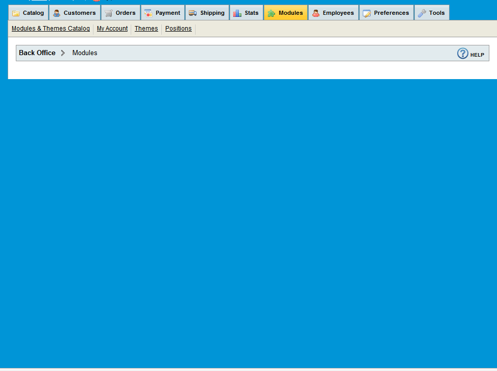

jcmil Posted October 4, 2012 Author Share Posted October 4, 2012 (edited) Thanks for the info. I installed the backward compatibility module then uploaded the PP module - my modules page now looks like this - it does load past this point if I log out & in again. I didn't get to the point of seeing the file upload & be selectable for install. Screen changed during/at end of upload & now I'm stuck... UPDATE Somehow I recovered it by playing with the positions/hooks selection & it's working OK Edited October 4, 2012 by jcmil (see edit history) Link to comment Share on other sites More sharing options...
