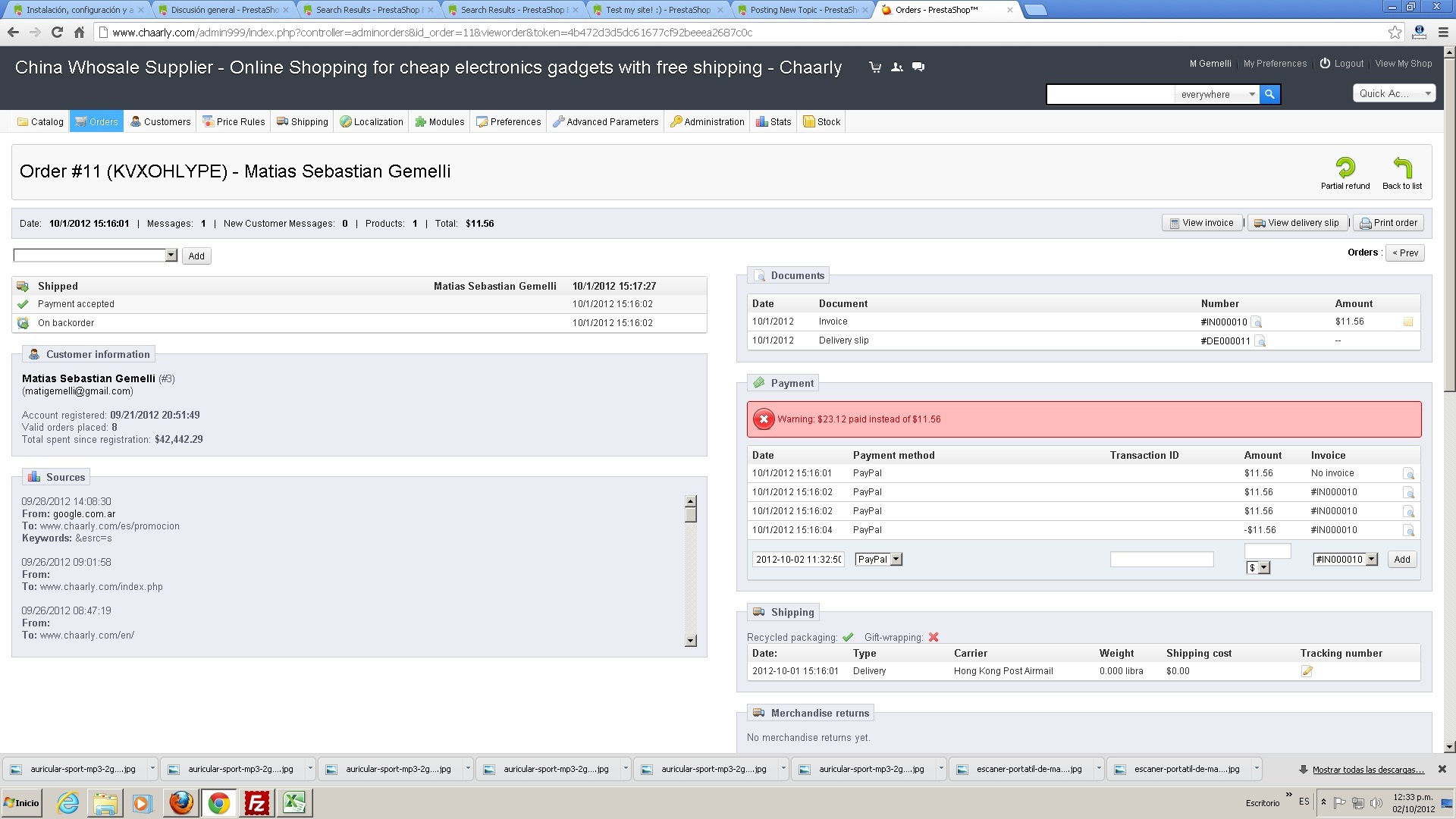

matigemelli Posted October 2, 2012 Share Posted October 2, 2012 Hi i have a problem , when i recivied a payment, the payment is ok but in the back office i recivied a warning that says for example Warning: $23.12 paid instead of $11.56 overpaid i attach the file the image. can anyone help me?i have the last version PrestaShop™ 1.5.0.17 Link to comment Share on other sites More sharing options...

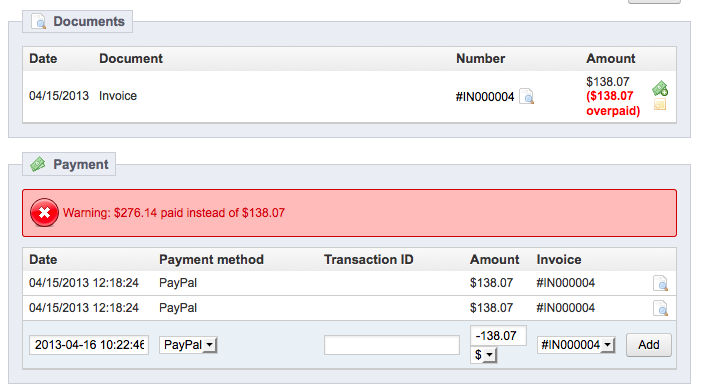

techfirestudio Posted April 16, 2013 Share Posted April 16, 2013 Hello, I'm having the same problem. Although for me it only doubles the order price in the "Payment" section on the order page. The total at the bottom is correct. Also in my Paypal account the charges are correct. I work in IT and it's anoying our sales team, I've informed them to continue and not hold back on completing orders however this is something we need to get fixed soon. I will be digging in to this to try to find a fix and will post back here if I turn up anything worth mentioning. Thanks in advance to anyone who can help us out! TFS P.S. I attached a screen shot. Link to comment Share on other sites More sharing options...

techfirestudio Posted June 28, 2013 Share Posted June 28, 2013 I'm using Prestashop 1.5.4.1 and had this problem before I upgraded from 1.5.4 I'm using Paypal (latest version). If I go into myPHPadmin I can delete the duplicate payment entry from tables ps_order_invoice_payment and ps_order_payment, the error goes away, but I have to do this after each order. For some reason it is duplicating the payment record in the database, there are no other duplicated entries that I have found. I have to agree with jareq, it shows the errors on the online version, but my EXACT copy of the database and files on my localhost server works fine, it does NOT add the duplicate entries like the online server does. (I'm hosting on iPage.com) Link to comment Share on other sites More sharing options...
Denver Prophit Jr. Posted April 15, 2015 Share Posted April 15, 2015 I noticed in the payment status called "payment accepted" that the selection to mark order as paid was ON. Still getting duplicate payment in that table. Once when they go to paypal and then again when the IPN hits the site back and BO think there is an overpayment. PS 1.6.0.14 and the latest release of Paypal USA & Canada is 3.8.0 Link to comment Share on other sites More sharing options...
