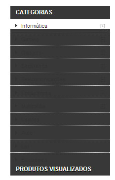

ALMAJ Posted March 21, 2014 Share Posted March 21, 2014 site url? Hi shacker, it's not working with Prestashop 1.5.6.2 everything is black strips my url: www.tekcenter.pt/store Prestashop ver: 1.5.6.2 (default theme) thanks Link to comment Share on other sites More sharing options...
shacker Posted March 29, 2014 Share Posted March 29, 2014 just tested in 1.5.6.2 and works. Link to comment Share on other sites More sharing options...
