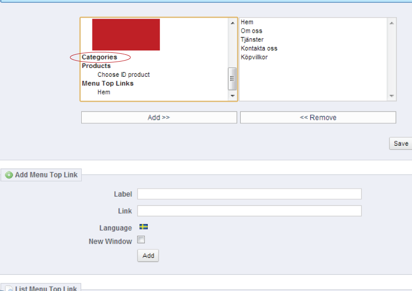

nextday_se Posted January 23, 2013 Share Posted January 23, 2013 ] Hi Guys, I hope this solves your problem like it did mine (I don't have multistore in my setup but shouldn't be a factor). Log into the admin area of your store. Step 1: Create your category as usual. Catalog -> Categories -> Add new Step 2: Click on modules -> modules Step 3: Search for "Top Horizontal Menu" in the modules window Step 4: Click "configure" Step 5: In the settings frameset, scroll down in the first box on the left, till you get to categories sub section. Select your desired category and click "Add". Your category will be added to the right box. Click "Save". Step 6: Refresh your store. Do let us know if this works for everyone. This doesnt work for me...I'm getting crazy. I cant see the categories in the Top Horizontal Module Configuration... Anybody who has a solution for this? Link to comment Share on other sites More sharing options...
Anoushka Posted January 29, 2013 Share Posted January 29, 2013 ] This doesnt work for me...I'm getting crazy. I cant see the categories in the Top Horizontal Module Configuration... Anybody who has a solution for this? Have you tried resetting the module? Or uninstal > install? Link to comment Share on other sites More sharing options...
