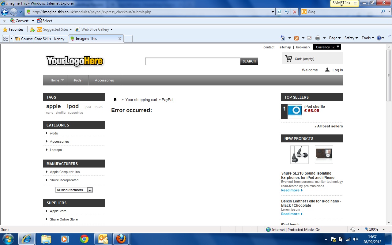

kennyg Posted September 28, 2012 Share Posted September 28, 2012 Hi, I'd be really grateful for any advice on sorting out my problem with paypal in 1.5 I've a fresh install and installed the latest version of the paypal module and it all looks great (loving the look of 1.5). I'm trying to get payment sorted before I start customising and adding products etc. The checkout works great for cash on delivery etc but using paypal it goes all the way to the end and then when I click to pay by paypal I get a page which just says Error occurred. I also get an e-mail from the backend office titled Error reporting from your paypal module which says - a client has encountered a problem with the module PayPalAPI, see the report: I thought the problem was with my paypal so I made sure it is verified and the API details are correct. I'm really struggling with what to try next, any help hugely appreciated. I can give back end access if required etc. Cheers, Kenny G Link to comment Share on other sites More sharing options...

kennyg Posted September 28, 2012 Author Share Posted September 28, 2012 Hi, I'm not sure where to find any error report, the message that comes up on the screen just says Error occurred. The e-mail mentions an error report but there is nothing in the e-mail and I can't find anything in the back office. Cheers, Kenny G Link to comment Share on other sites More sharing options...
ikakey Posted September 28, 2012 Share Posted September 28, 2012 (edited) Hello, what is the error message shown in the report? Please refer to logs: PayPal response: TIMESTAMP -> 2012-09-28T17:04:57Z L_ERRORCODE0 -> 10605 L_SHORTMESSAGE0 -> Transaction refused because of an invalid argument. See additional error messages for details. L_LONGMESSAGE0 -> Currency is not supported L_SEVERITYCODE0 -> Error Edited September 28, 2012 by ikakey (see edit history) Link to comment Share on other sites More sharing options...
