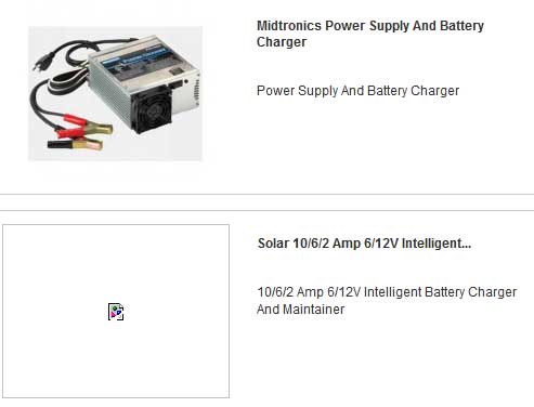

Now on 1.5 - if you click the same url, instead of redirecting to 404.gif.. it takes me to :
http://mydomain.com/page-not-found -> so thumbnails etc are not getting the 404.gif for products without images. (see image below)

Then when you upgrade to 1.5, the products don't display the above image, it will give you a missing image icon like this:

I switched off friendly urls, then inspected the missing images with firebug. I found that they were trying to retrieve images from the folder root/img/p when I looked in the folder, many of those images didn't even exist. I tried to generate them from the back end but it wasn't doing anything. So I created them manually and placed them in the folder (I attached the images in a zip file...you can copy them into the root/img/p folder if they aren't there and if you need them).
