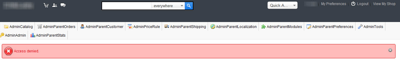

redshop Posted September 23, 2012 Share Posted September 23, 2012 I have a problem with "access denied" error occur after edit language, and after that every menu I click it show "access denied" like picture link below please suggest. Link to comment Share on other sites More sharing options...

musicmaster Posted October 16, 2012 Share Posted October 16, 2012 Hello Benjamin, No database info yet? With losing access I mean that I get a blank screen in the BO and internal server error (500) at the FO. Today I tried what happened with this setting if I enable the error settings on this installation. The result was an "offline" message at the FO (what of course is correct as I switched the shop off for the upgrade) and the attached screen in the BO. I compared the database of this failed installation with that of a successful update on a test computer. The differences were too extensive to list: on the server all tables alphabetically before attachment were missing (including access) while the server had many _shop tables that the test update missed. Link to comment Share on other sites More sharing options...
