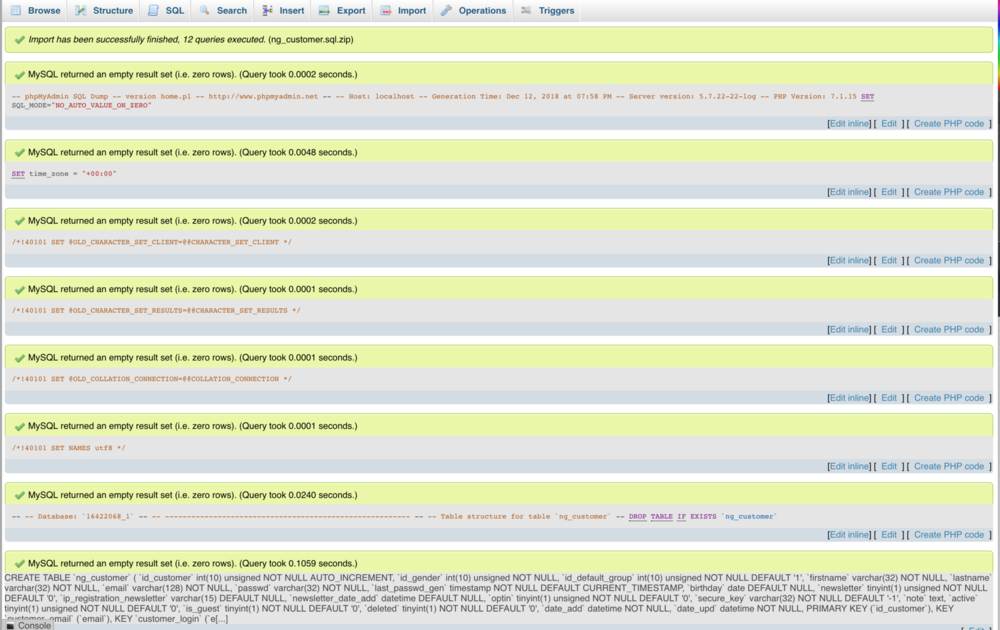

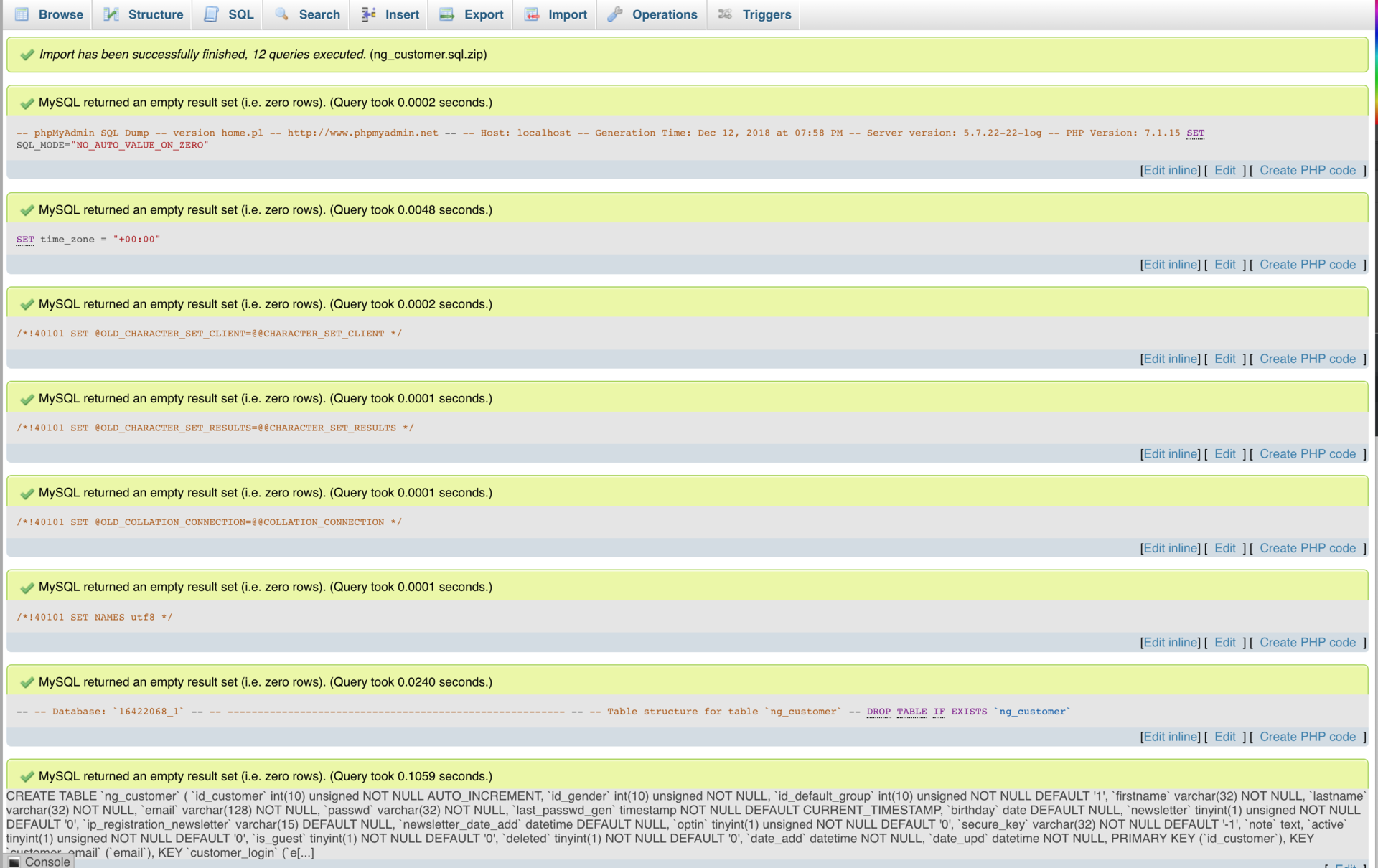

I want to hug you mate, buy flowers and marry. Thanks a million for this instruction, after hard fight it worked on my server!
