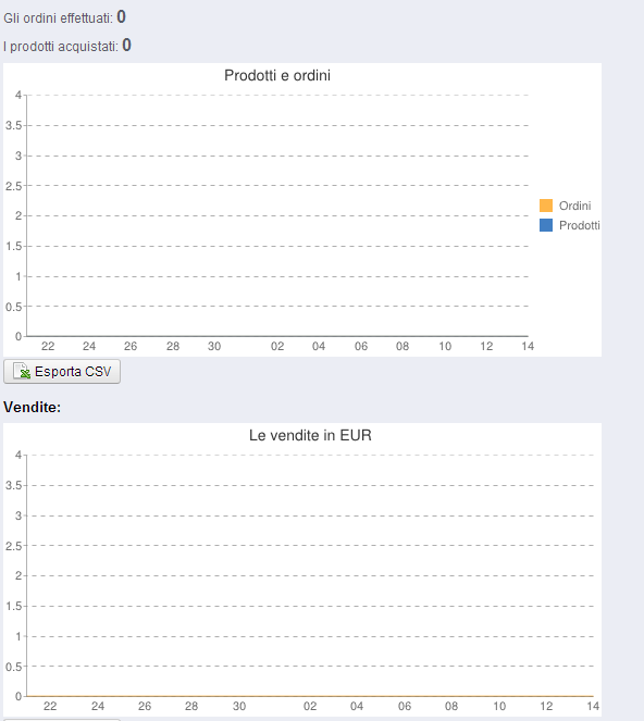

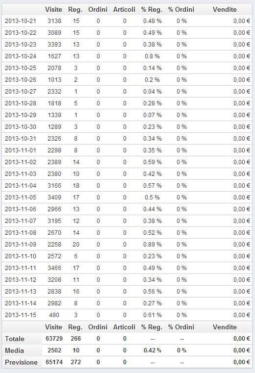

bluego78 Posted November 15, 2013 Share Posted November 15, 2013 Any other solutions?I'm using 1.5.2 and statistic doesn't work.. only visits are available, the other are always ZERO :-( I've tried all the possible solution... but nothing happens... these are what i've done/check: 1) Conversion rate in ps_orders is set to 1 (it was just ok) 2) AdminStatsTabControllerCore extends AdminPreferencesController (but it just work before) 3) Statistic data module is just hooked to Footer Orders are 0 Product selled are 0 This is strange... because i receive from 10 to 30 orders per day... Please any other ideas? Link to comment Share on other sites More sharing options...
