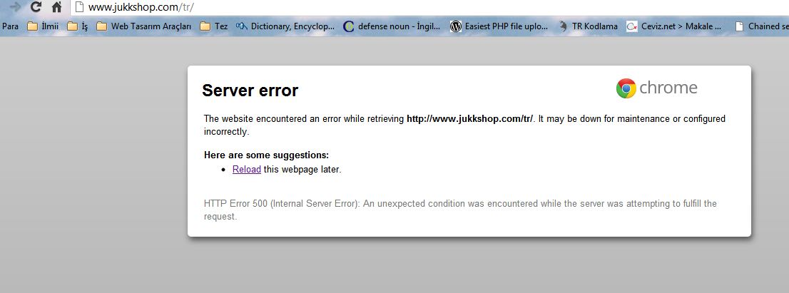

mecjos Posted September 16, 2012 Share Posted September 16, 2012 Hi, I have just upgraded my store from 1.4.7 to 1.5.17 and after upgrading I can not reach my front office, it gives internal server error. But I can log in to my admin panel. Additionally, I can not open some pages in admin panel (modules page, permissions page and some other pages..). That pages give same internal server error.. You can see a error page's screen shot in attached file. Thank you Link to comment Share on other sites More sharing options...

CrS27 Posted September 17, 2012 Share Posted September 17, 2012 Server error 500 may be due to a configuration problem with the server, and most often it's due to error in the .htaccess or possibly a php.ini Most probably it isn't in a PHP script, the web server can't even get to that, because it's still processing how to handle the page request, so it uses the config files (httpd.conf and .htaccess files), but if there;s something it can't process, you see 500 error Check you .htaccess, be sure the file permissons are valid for the version of Apache you run. and also what about Mod rewrite rules with regular expressions? They may be the cause of the problem too. I know it's a lot of things to examine, and if you don't know how to do it correctly, better let a pro do it. I've also found an article on Presta configuration, it may be useful for you. Link to comment Share on other sites More sharing options...

mecjos Posted September 18, 2012 Author Share Posted September 18, 2012 I opened the error messages from config file and it gave following error; "Fatal error: Cannot make non static method ModuleCore::display() static in class PayPal in /home/content/01/9118201/html/modules/paypal/paypal.php on line 36" Link to comment Share on other sites More sharing options...
CrS27 Posted September 18, 2012 Share Posted September 18, 2012 Looks like this is a problem with PayPal module. maybe you should reinstall it. Link to comment Share on other sites More sharing options...
Kerm Posted September 18, 2012 Share Posted September 18, 2012 Try just delete paypal folder from /modules/ it can help! Link to comment Share on other sites More sharing options...
