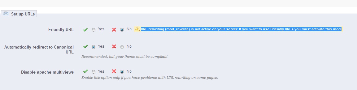

mod_rewrite and .htaccess don't work
I have the next problem and I don't know how to solve It.
When I add a new shop, in "virtual url" field It says that mod_rewrite seems not to be activated in my server, but I spoke to my host server and they confirm to me that It is actived, and they tell me that I have to change the code of .htaccess reading this http://support.godad...-use-modrewrite but I view in my htaccess that says the code is created automaticatly
"# ~~start~~ Do not remove this comment, Prestashop will keep automatically the code outside this comment when .htaccess will be generated again
# .htaccess automaticaly generated by PrestaShop e-commerce open-source solution"
So I don't know what to do, could someone to help me.
My store is: www.centralpedidos.com/herbalife
Thanks

Yes I have .htaccess in my root wich is: www.centralpedidos/herbalife/
I chequed if my mod_rewrite is working with the link you gave me and It is working.
So I activate friendly urls, but doing this the site doesn't work. I think because I didn't make the second part of the second point that you told me:
  • try activating friendly urls and regenerate the htaccess file
To regenerate the htaccess file, do I have to click any button?
on ps1.5 you just click save on the seo page and i think it automatically generates the htaccess code. in 1.4 you had to create a htaccess file and then click generate, in 1.4 you had this cool option where you could add your own htaccess code.
easiest way to see it it has worked is to see if the code has been added to the htaccess.
when you say it does not work, what is not happening exactly?
I noticed that your site is going to be spanish, maybe this is a fault with a non english site
in your admin panel on the seo page, is the Base URI set right for your location of your shop, /herbalife/ ?
when you checked rewriting was working, did you try this in the full webroot, ie www.centralpedidos.com , some webhost will not scan sub folders for htaccess files, some hosts it can tak up to 2hours before it scans the file. Try the mod rewrite test in the subfolder www.centralpedidos.com/herbalife . lastly for now check and see if there is any rules in the root .htaccess that would prevent the sub folder htaccess from working.
lastly, when you created a htaccess file, did you put the . at the front. the file name should be .htaccess
other than these suggestions it must be a fault with multishop, i have never used this so i cannot help you there but it sounds like an issue with PS or one of its settings rather than your server.

Thanks for your help Shoulders... It doesn' work.
My version: 1.5.0.15
I deleted my htaccess and created a new blank one, later I click save on the seo page and automatically generates the htaccess code:

the htaccess looks fine (same as my ps1.5)
just a quick note, i have gone to your site and it is displaying a 403 error, this means forbidden. there might be issues with permissions somewhere. I also noticed /ese/ was missing of the end. This points towwards the fault being before prestashops code is being called.
check you erver logs and see if there are any errors that help you find the issue.
if possibly install prestashop again from the begining but use only one language.
also look up a function called symbolic links. try adding these lines before your presashop code in the htaccess.
# enable symbolic links
Options +FollowSymLinks
Base URI should be /herbalife/
Edited by shoulders (see edit history)
I deleted all my ftp and db to setup from 0 all prestashop.
It works perfectly until I activate "url friendly" that creates .htaccess and the front-end doesn't work.

i saw on admin seo page -->warning URL rewriting (mod_rewrite) is not active on your server. If you want to use Friendly URLs you must activate this mod.

I still see di the warning on seo page. how i fix this!!
