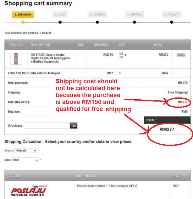

alabasta Posted October 23, 2012 Share Posted October 23, 2012 Hello I am new to PS and just try in my test site about 2 weeks ago. i am using 1.5.1.0 and I have trouble with Shoppping cart summary. My Cart Rule is to give free shipping for purchase above RM150. Purchase below that will have shipping cost. But when I try with test product, the Free Shipping is appear but in the same time, it calculate the shipping cost. Where should i fix to stop calcutate shpping cost for purchase above RM150? Thanks Link to comment Share on other sites More sharing options...

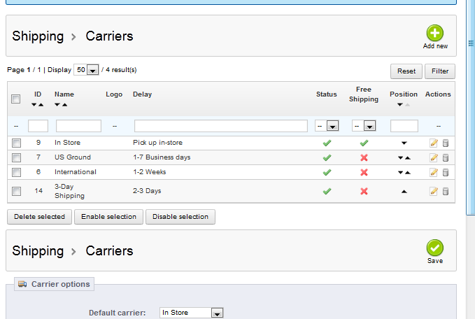

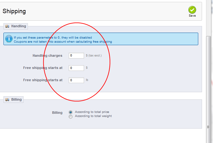

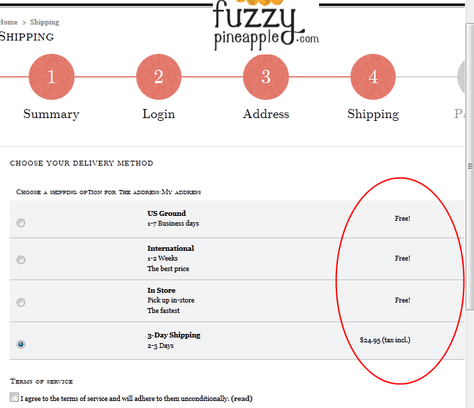

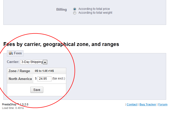

The Fuzzy Pineapple Posted January 2, 2013 Share Posted January 2, 2013 Hi! I'm running prestashop 1.5.2 and I had this same problem. I finally figured it out thanks to everyones help. Note: My shop has free shipping at $75 not $50. The 1st picture is when the cart has less than $75 and the last picture is when the cart totals over $75 Step 1: Set all handling and shipping to 0 Step 2 : Set up price ranges for each carrier 0 to $49.99 and 50.00 to 1000000000+ Step 3: Go to each zone and define a shipping rate based on each price range $0-49.00= $5.95 and $50-100000000+ = $0.00 Step 4: For express mail (3-day shipping) set your range to 0-1000000000+ and just set the shipping to your specific price $24.95 Done! 1 Link to comment Share on other sites More sharing options...

The Fuzzy Pineapple Posted January 2, 2013 Share Posted January 2, 2013 I didn't set any cart rules. Just price ranges. If people pay up to $74.99 their shipping is $5.95. If they pay $75 or more their shipping range switches to $0.00 (Free). That is just for US ground shipping (carrier). I set the 3-day shipping (carrier) to only be allowed for North America (done in zones) and then set the price range for that to cover all price ranges $0.00 to 10e+14 (the highest number prestashop will allow). So now only people purchasing in North America will be offered 3-day shipping and no matter what their cart totals, they will always have to pay $24.95 if they select 3-day shipping. (which is really 1-2 day shipping so it's guaranteed to be there on time.) The tutorial is a step by step guide of everything I did. 1 Link to comment Share on other sites More sharing options...
