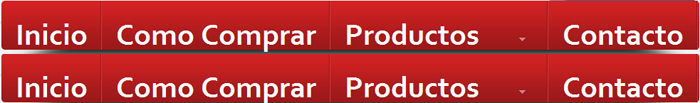

Syd Posted August 13, 2012 Author Share Posted August 13, 2012 Una imagen vale más que mil palabras no?, jeje El tamaño horizontal del menu cambia. Opera y Chrome son casi iguales, o iguales Link to comment Share on other sites More sharing options...

Syd Posted October 4, 2012 Author Share Posted October 4, 2012 Gracias, Nadie, me has hecho pensar. Entré en el css del módulo y encontré esto. Intenté eliminando una de las dos, pero quedó igual. /* Fonts */ #topmenustyle ul.topmenustyle li a span { font-family: Arial; font-size: 13px; font-weight: 600; } #topmenustyle ul.topmenustyle li div ul li a span { color:#5E5E5E; font-family: Trebuchet MS; font-size: 12px; font-weight: 400; } Bueno, pego el menu.css entero: #topmenustyle * { margin: 0px; padding: 0px; list-style-type: none; text-decoration: none; z-index:2007; } div#topmenustyle { position:relative; /*Position of the menu according to the homepage*/ padding-bottom:4px; } #topmenustyle ul.topmenustyle { white-space: nowrap; } /* Geometrical arrangement */ #topmenustyle ul.topmenustyle li { display: inline-block; height: 46px; position: relative; } #topmenustyle ul.topmenustyle li div { position: absolute; top: 46px; left: 0px; } #topmenustyle ul.topmenustyle li div div { position: absolute; top: -6px; left: 188px; } /* Escaping style for lower levels */ #topmenustyle ul.topmenustyle li div ul li { display: block; float: none; width: auto; height: auto; } /** Graphics **/ /* Horizontal sliding doors */ #topmenustyle ul.topmenustyle li a { padding-left: 13px; background-image: url("images/item1.png"); background-repeat: no-repeat; background-position: left -1000px; display: inline-block; margin: 10px 2px; } #topmenustyle ul.topmenustyle li a span { padding-right: 14px; padding-left: 0px; background-image: url("images/item1.png"); background-repeat: no-repeat; background-position: right -1000px; display: inline-block; height: 27px; line-height: 27px; cursor: pointer; } #topmenustyle ul.topmenustyle li:hover a { background-position: left -54px; } #topmenustyle ul.topmenustyle li:hover a span { background-position: right -81px; } #topmenustyle ul.topmenustyle li.current a { background-position: left 0px; } #topmenustyle ul.topmenustyle li.current a span { color: #FFFFFF; background-position: right -27px; } /* Escape Horizontal doors */ #topmenustyle ul.topmenustyle li div ul li a { display: block; padding: 0px; margin: 0px; background: none; } #topmenustyle ul.topmenustyle li div ul li a span { display: block; padding: 0px; background: none; height: auto; width: 165px; line-height: 25px; padding: 7px 0 7px 9px; white-space: normal; } /* Vertical sliding doors */ #topmenustyle ul.topmenustyle li div { width: 200px; padding-top: 6px; background-image: url("images/submenu-top.png"); background-repeat: no-repeat; background-position: 0px top; } #topmenustyle ul.topmenustyle li div ul { padding: 6px 6px 9px 6px; padding-top: 0; background-image: url("images/submenu-bottom.png"); background-repeat: no-repeat; background-position: 0px bottom; } /* Hover Effect on Submenus */ #topmenustyle ul.topmenustyle ul li:hover { } #topmenustyle ul.topmenustyle li.current ul li a span { color: #5E5E5E; width: 165px;} #topmenustyle ul.topmenustyle li.current ul li a span:hover { color:#09C6F5;} #topmenustyle ul.topmenustyle ul li a span:hover { color:#09C6F5; } /* Main header line */ #topmenustyle { height: 46px; padding-left: 14px; background:transparent url(images/bg.png) repeat-x; clear: both; z-index:2007; } /* Text shadow */ #topmenustyle span { color: #EB2E83; } #topmenustyle li:hover>a>span { color: #FFFFFF; } /* Fonts */ #topmenustyle ul.topmenustyle li a span { font-family: Arial; font-size: 13px; font-weight: 600; } #topmenustyle ul.topmenustyle li div ul li a span { color:#5E5E5E; font-family: Trebuchet MS; font-size: 12px; font-weight: 400; } /* Lines between li */ #topmenustyle ul.topmenustyle li div ul { padding-bottom: 8px; } #topmenustyle ul.topmenustyle li div ul li:first-child { border-top-width: 0px; } /* Menu logic */ #topmenustyle li>div { visibility: hidden; } #topmenustyle li:hover>div { visibility: visible; } /* */ /* Hover Effect on Subtopmenustyles */ #topmenustyle ul.topmenustyle ul li:hover { background-color: #fff; } /* Lines between li */ #topmenustyle ul.topmenustyle li div ul li { background-image:url(images/hr.gif); background-repeat: repeat-x; background-position: left bottom; } #topmenustyle ul.topmenustyle ul a.parent { background: url(images/arrow.gif) no-repeat right center; margin-right: -1px; } /* ie7 */ #topmenustyle ul.topmenustyle li { *zoom: 1; *display: inline; } #topmenustyle ul.topmenustyle li a { *zoom: 1; *display: inline; } #topmenustyle ul.topmenustyle li a span { *zoom: 1; *display: inline; } /* IE6 */ #topmenustyle ul.topmenustyle li a { _background-image: url("images/item.gif"); } #topmenustyle ul.topmenustyle li a span { _background-image: url("images/item.gif"); } #topmenustyle ul.topmenustyle li div { _background-image: url("images/submenu-top.gif"); } #topmenustyle ul.topmenustyle li div ul { _background-image: url("images/submenu-bottom.gif"); } #topmenustyle ul.topmenustyle li a:hover { _background-position: left -54px; } #topmenustyle ul.topmenustyle li a:hover span { _background-position: right -81px; _color: #FFFFFF; } #topmenustyle ul.topmenustyle li li a:hover span { _color:#09C6F5; } /* Menu logic for IE6 */ #topmenustyle div { _display: none; } #topmenustyle div li:hover div { _visibility: visible;_display: block; } #topmenustyle div li:hover li:hover div { _display: block; } #topmenustyle div li:hover li:hover li:hover div { _display: block; } /* */ #topmenustyle span.search { display:block; padding:10px 10px 10px 10px; } span.search input { -moz-border-radius: 10px 10px 10px 10px ; float:right; padding: 3px 0; padding-left: 10px; margin-top: 4px; background: #CCCCCC url(images/search.png) no-repeat left center; font-weight:bold; height:24px; } Link to comment Share on other sites More sharing options...

nexxuseis Posted October 12, 2012 Share Posted October 12, 2012 (edited) Proba poniendo em en vez de px a ver como te queda, la otra vez lei que los em se comportan mejor, por ej font-size: 1.1em; si te sale muy grande anda bajando a 1em, 0.9em, etc. Edited October 12, 2012 by nexxuseis (see edit history) Link to comment Share on other sites More sharing options...
Syd Posted October 12, 2012 Author Share Posted October 12, 2012 Muchas gracias, así probé y quedó igual. Quizá debería pensar en otro menú, pero da rabia una vez pagado este Link to comment Share on other sites More sharing options...
nexxuseis Posted October 12, 2012 Share Posted October 12, 2012 (edited) Probaste en %? http://www.librosweb...ulo1/texto.html De todas formas si no hay solucion es porque tenes el menu completo a lo ancho, si tan solo te sobrara unos 50px no va haber problema, sino los productos menos importantes podes ponerlo en una categoria que diga "Otros Productos" y metes 2 o 3 subcategorias. Quizas es el font-family, yo tengo un menu con font-family: Corbel y font.size: 13px, para probar como se comporta le puse 43px y el tamaño con firefox-ie son casi identitos en cuanto al width (solo unos 2px de diferencia) Edited October 12, 2012 by nexxuseis (see edit history) Link to comment Share on other sites More sharing options...
Syd Posted October 13, 2012 Author Share Posted October 13, 2012 Gracias, de lo que me he dado cuenta es de que nada cambia ponga lo que ponga... o sea que aunque por ahí fuera la solución no puedo probarla. Y he probado cosas absurdas y todo, pero nada cambia. Estoy editando el css de la carpeta themes-custom del menu, que es el que elegí yo, personalizado. No se me ocurre mucho más... Link to comment Share on other sites More sharing options...
