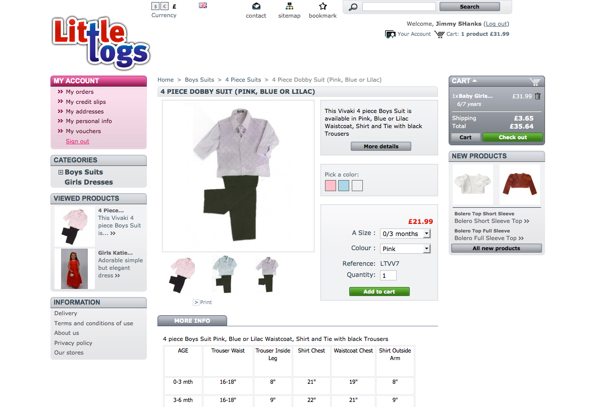

Can anyone help clarify the functionality of the colour picker and if it links to the images displayed?
I would like the colour picker to link to the correct colour image. So, if you have 3 shirts, pink, blue, and lilac, I would expect that when you click on the pink colour tile on the colour picker that the image would change to the display the pink shirt.
I have ticked the correct image within each colour attribute but with no success when you test it out on the live site.
This functionality seems to work on the demo but I can't get it working.
I'm using v 1.4.7.3, and the default theme.
OK. I think the problem is in having colour and size attribute groups. When I remove the size attributes the colour picker works as I would expect.
Does anyone have a suggestion as to how I can get the colour picker working as well as having size attributes on a product?
