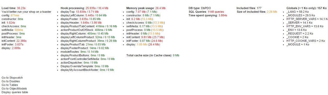

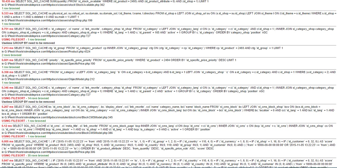

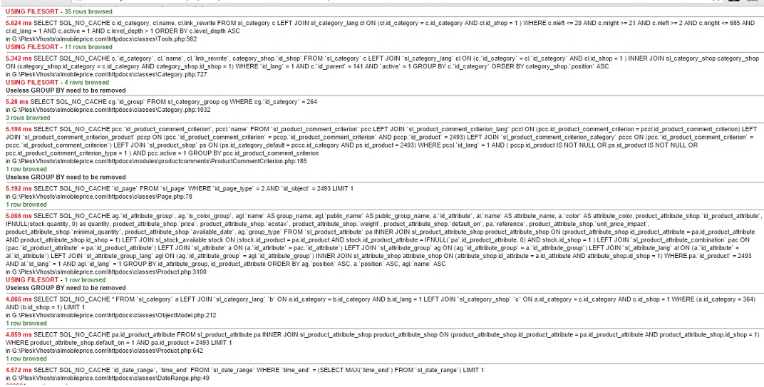

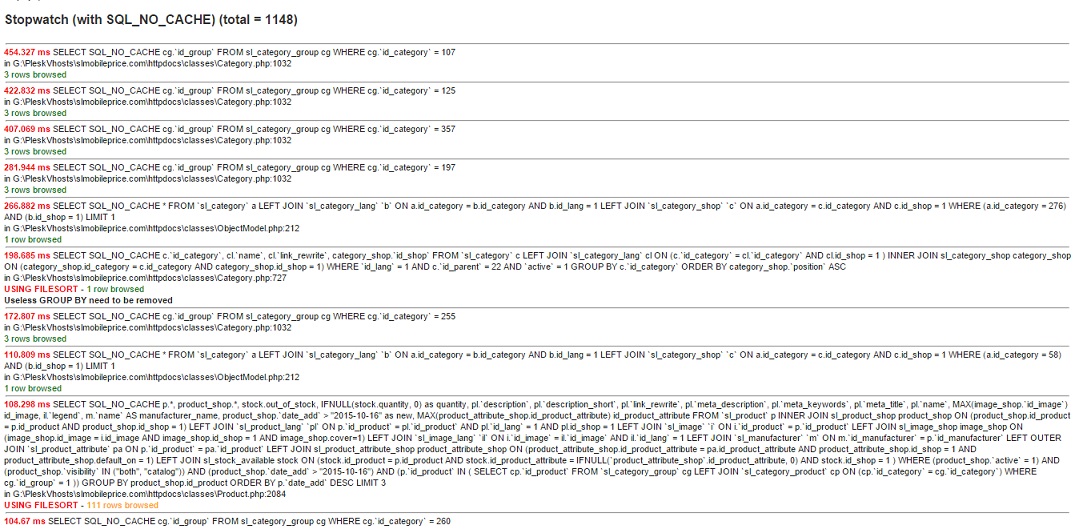

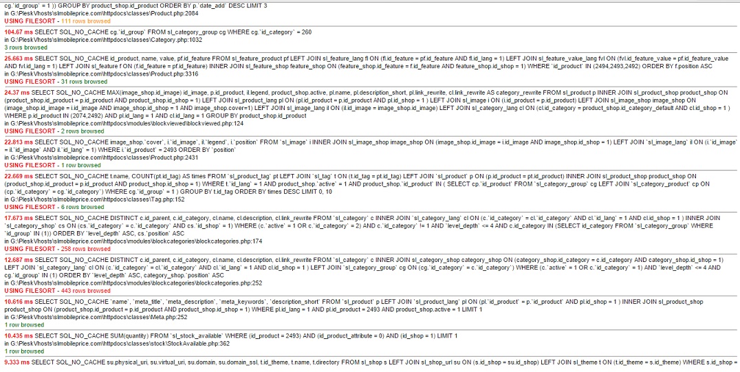

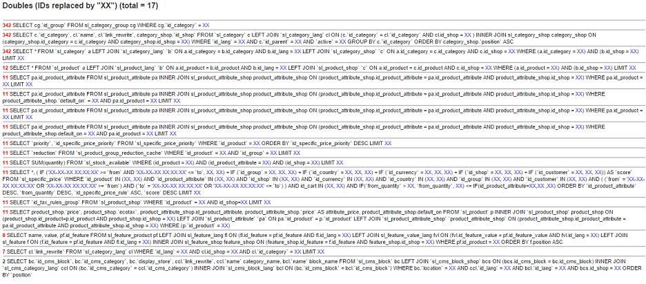

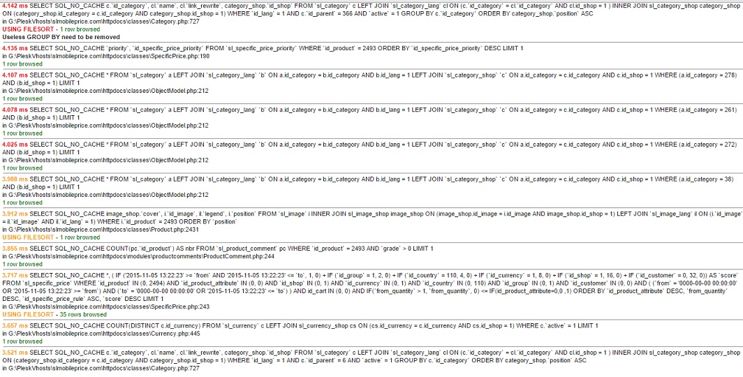

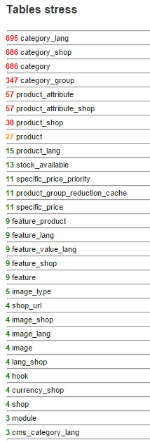

somits1 Posted November 5, 2015 Share Posted November 5, 2015 My site is working too slow, can anyone please help me. I am using Prestashop 1.5.6 english version for my website http://slmobileprice.com after enabling debug mode i got these screen shot please check error. please help me to understand the error as i dont know about coding. Link to comment Share on other sites More sharing options...

Scully Posted November 10, 2015 Share Posted November 10, 2015 5.3 seconds with cache cleared before measuring. Some images take more than 900 ms (0.9 sec) to get them from the different servers. Splitting them up to different subdomains does not help obviously. In my opinion: a) way to heavy images. Try to reduce them in size. overall to slow response time. c) google doubleclick and facebook connect are blocked within out network. This slow down a bit more. d) Start page loads appx. 650 kb of data. This is too much. As comparison: Our prestashop 1.5.6. loads appx. 230 kb of Data. See under http://mit100wir.ch/wirshop/ Link to comment Share on other sites More sharing options...

Scully Posted November 10, 2015 Share Posted November 10, 2015 And you have quite a lot of categories. Based on this structure, you should use a dedicated server or at least a server with SSD disks and 1 or 2 gb of ram. Link to comment Share on other sites More sharing options...
