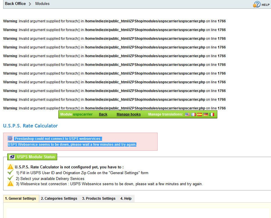

indie-Zine Posted July 25, 2012 Author Share Posted July 25, 2012 and, now I keep getting this. Link to comment Share on other sites More sharing options...

indie-Zine Posted July 25, 2012 Author Share Posted July 25, 2012 What about the error i'm getting above? Link to comment Share on other sites More sharing options...
tomerg3 Posted July 25, 2012 Share Posted July 25, 2012 If you want to use USPS for international shipping, you can look into our module http://www.presto-changeo.com/en/shipping-modules/61-usps.html Link to comment Share on other sites More sharing options...
Mike Kranzler Posted July 25, 2012 Share Posted July 25, 2012 What about the error i'm getting above? That error message usually means that your USPS account credentials are incorrect. Please make sure you've entered your API Key correctly and then try this again and let us know the result. -Mike Link to comment Share on other sites More sharing options...

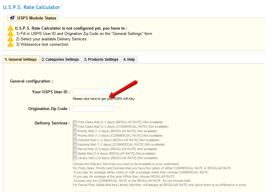

indie-Zine Posted July 25, 2012 Author Share Posted July 25, 2012 Registered Here... https://www.usps.com/business/become-webtools-provider.htm? Then, i Dont understand what this means. -------------------- 4. Request to be listed Email the USPS Web Tools program office at [email protected] in order to begin official listing process. In this email please indicate the specific USPS Web Tools your company supports. Be sure to tell us your USPS Web Tools username and the company name under which you’ve registered. 5. Get verified and approved. We will verify registration and use of the USPS Web Tools. Upon satisfaction of all criteria, your company will be listed as a service provider. Link to comment Share on other sites More sharing options...
Mike Kranzler Posted July 25, 2012 Share Posted July 25, 2012 Did you use the link provided in the module itself? It should not redirect you to the page you linked above. -Mike Link to comment Share on other sites More sharing options...

arizonak Posted July 30, 2012 Share Posted July 30, 2012 So come on Prestashop, what is the secret to getting the USPS module working. I have uninstalled and reinstalled the module, checked and double and triple checked all my detaills, I have the latest version of the module, you HAVE TO HELP US!!!!! Link to comment Share on other sites More sharing options...
Mike Kranzler Posted July 31, 2012 Share Posted July 31, 2012 Hi arizonak, Can you please provide the specific error message(s) you are receiving? -Mike Link to comment Share on other sites More sharing options...
arizonak Posted July 31, 2012 Share Posted July 31, 2012 Hi arizonak, Can you please provide the specific error message(s) you are receiving? -Mike Hi Mike, I responded to your email, hope you got it because now I am having the same problem with UPS module, error message for USPS is: Prestashop could not connect to USPS webservices : USPS Webservice seems to be down, please wait a few minutes and try again. error message for UPS is: Prestashop could not connect to UPS webservices : UPS Webservice seems to be down, please wait a few minutes and try again What's happening here? Link to comment Share on other sites More sharing options...
Mike Kranzler Posted July 31, 2012 Share Posted July 31, 2012 Hi arizonak, Please check with your hosting provider to see if allow_url_fopen is enabled on your server. These modules will not work without it. -Mike Link to comment Share on other sites More sharing options...
arizonak Posted August 2, 2012 Share Posted August 2, 2012 Having now got my USPS and UPS Modules working, I thought I would share with you how that came to be. I badgered my Hosting provider, Westhost, to have a look at the 'allow_url_fopen' and the found that it defaults to 'no'. Here follows messages from them explaining what they did for me. 1.Hi I've placed a php.ini file in your arizonak/dir/ folder and enabled the php setting fopen. Please let us know if you have any further issues with this. it still was not working so: 2.Hi Bernard, Thank you for your reply. I had placed it in the exact directory that your install was located in, because it wasn't working I just moved it up one directory and applied a setting to make the fopen option recursive (apply to everything) and you should now have fopen enabled for your account. I thanked the tech support and asked them if it was ok to pass on their fix 3.Hi Bernard, Thank you for your reply. Sure you can share the fix on the prestashop forums, to clarify a little better this is what I did: I placed a php.ini file in your web root for your website the most important part was that it contained the following code: allow_url_fopen = On I then created a .htaccess file and placed it in the same folder with the following line: SetEnv PHPRC /home/arizonak/home/arizonak/php.ini This is a direct link specifying the location of the php.ini file on the server (to customize you would replace /home/arizonak/home/arizonak/ with the proper location of your php.ini file) It uses this file as the environment for all subdirectories (this way you can enable fopen for just part of your hosting account instead of all of it). Any content that is not contained within the arizonak folder will not have fopen enabled, consequently making your hosting account more secure than otherwise. I hope this helps someone, now I just have to get my Paypal API working, when I make a trial purchase I get an error message Link to comment Share on other sites More sharing options...
