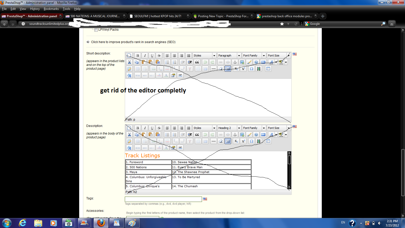

invayne Posted July 23, 2012 Share Posted July 23, 2012 im trying to simplify the entry fields for product description an short description the text editor in the back office is to buggy an confusing for some of my employees. so when your trying to put in 1 thousand plus items it takes for ever. an being a collector selling items of the same kind it just takes to much time when inputing the items. im not asking some one to code this for me but to point me in the right direction on were i should go to start coding it my self. any help would be great heres a pic of what im trying to do just to explain it better.change this to look like this thanks in advance Link to comment Share on other sites More sharing options...
tomerg3 Posted July 24, 2012 Share Posted July 24, 2012 You will need to edit /admin/tabs/AdminProducts.php to modify the product editor display. Rather than add new fields (which requires overriding the product class and adding field to the DB), try reusing some of the existing product editor elements (like "location"). You can also exclude the tinyMCE editor from that page, don't recall off the top of my head where the JS code for that sits, liekly in an external JS file that is loaded there. Then edit product.tpl file to arrange the fields to display as you wish., Link to comment Share on other sites More sharing options...

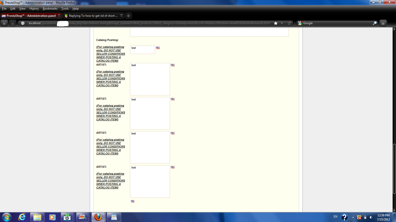

invayne Posted July 25, 2012 Author Share Posted July 25, 2012 (edited) ok so ive got it to allow me to add more entry fields using the same code as above with an extra echo ' at the beginning of each field code. which is good but it will only allow to save text in the last textarea field an it duplicates the text in to every field as shown in the picture below. Now is this were i have to create new tables in the DB in order for it to work correctly? Like if i switch the code around to add the new db tables an then still use the description id in order for it to show on the products description page or will i need more code in order to stack the new text fields correctly on the description page? Edited July 25, 2012 by invayne (see edit history) Link to comment Share on other sites More sharing options...
