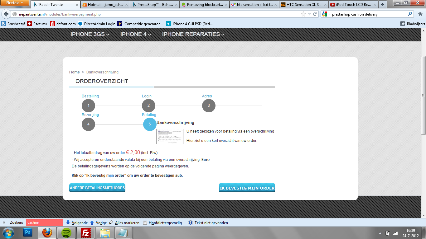

I got a little problem. I just installed a new theme to my prestashop (electroshop). It has a cool shopping cart module on the right.
But, when I want to complete my order as a costumer, normally the blockcart module dissapeares, so there is enough space. Suddenly on the last two pages (bankwirepayment and order confirmation), the module comes back, so there isnt enough space for the rest.
How can I edit this?
webadres:
www.irepairtwente.nl (netherlands)
image file where you can see the problem:
http://s11.postimage.org/mrfs3846r/problem.jpg
Looking foward to your reactions!

Ok dear Jarnau,
Now it seems that you need the header.tpl fix that we talked about in previous post. (your perhaps reinstalled your whole theme ?)
And everything is going be all right. ;)
