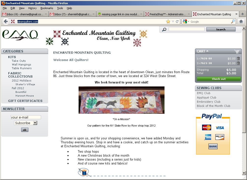

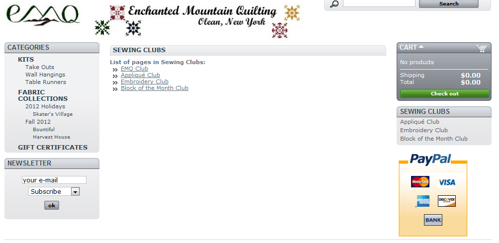

sherrie Posted July 17, 2012 Share Posted July 17, 2012 This is only the 2nd time I have posted here so I am hoping this is the "For Dummies" spot. First time installing a cart and I am NOT a developer. Not even close. Only know a bit of HTML. So I hope I have the lingo correct. I have a CMS module on Right Column that will not show one of my page links. On this page, if you click on the category heading "Sewing Clubs" it shows the 1st of 4 pages. That's the missing link...no pun intended. http://oleanquilters.com/ Any and all advice will be appreciated. Thanks, Sherrie Link to comment Share on other sites More sharing options...
Mike Kranzler Posted July 17, 2012 Share Posted July 17, 2012 Hi Sherrie, I apologize, but I think I'm a little confused. What exactly is missing here? When I click on that link, I see 4 different pages, and all 4 links appear to work: Is this not what you're seeing on your end? -Mike Link to comment Share on other sites More sharing options...
sherrie Posted July 17, 2012 Author Share Posted July 17, 2012 Hi Mike, Thanks for the reply. Look at the module on the right column and you will see that the first link, "EMQ Club" is missing in the module. S Link to comment Share on other sites More sharing options...

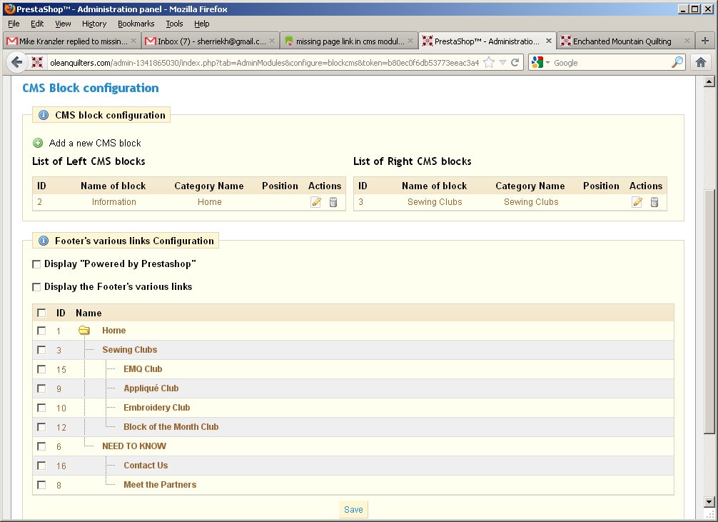

Mike Kranzler Posted July 17, 2012 Share Posted July 17, 2012 What I'm asking is what page do you want a screenshot of? module>positions? Or sucategories creation page? Or?? Modules > CMS Block > Configure And to attach a screenshot, just use the "More Reply Options" button at the bottom of the entry window. Attach the file there, and then be sure to click the button "Insert into post." -Mike Link to comment Share on other sites More sharing options...

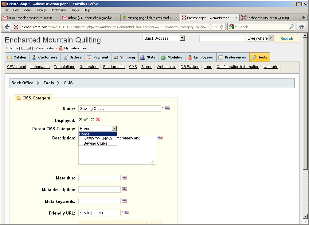

sherrie Posted July 17, 2012 Author Share Posted July 17, 2012 Well, a couple of things. My Modules menu does not have the options you listed. I'm attaching a screenshot that may or may not be where the snag is because I keep wondering how it is that "Home" gets to be a category. Also....I have a whole module that is missing. You wioll see it in the photo. Also... this all happened after I bought and installed and addon, so I uninstalled it to see if that would help. I don't think it right for me to mention its name because I assume it is my ignorance that caused this. Like I said, this is a first for me. Link to comment Share on other sites More sharing options...
Mike Kranzler Posted July 17, 2012 Share Posted July 17, 2012 Well, a couple of things. My Modules menu does not have the options you listed. I'm attaching a screenshot that may or may not be where the snag is because I keep wondering how it is that "Home" gets to be a category. Also....I have a whole module that is missing. You wioll see it in the photo. Also... this all happened after I bought and installed and addon, so I uninstalled it to see if that would help. I don't think it right for me to mention its name because I assume it is my ignorance that caused this. Like I said, this is a first for me. Do you not have a "CMS Block" module in your Back Office under Modules > Front Office Features? What version of PrestaShop are you using? -Mike Link to comment Share on other sites More sharing options...
sherrie Posted July 17, 2012 Author Share Posted July 17, 2012 Prestashop version: 1.4.7.3 Ahh...that page...the one I call "the tree page" heh heh. Sure, see attached. Link to comment Share on other sites More sharing options...
Mike Kranzler Posted July 17, 2012 Share Posted July 17, 2012 Can you please also post a screenshot of the configuration for the "Sewing Clubs" Right CMS Block? -Mike Link to comment Share on other sites More sharing options...
sherrie Posted July 17, 2012 Author Share Posted July 17, 2012 Oh my! Do you think maybe I need a check mark there? S Link to comment Share on other sites More sharing options...
sherrie Posted July 17, 2012 Author Share Posted July 17, 2012 Bingo! See attached. I thank you sooo much!! Link to comment Share on other sites More sharing options...
