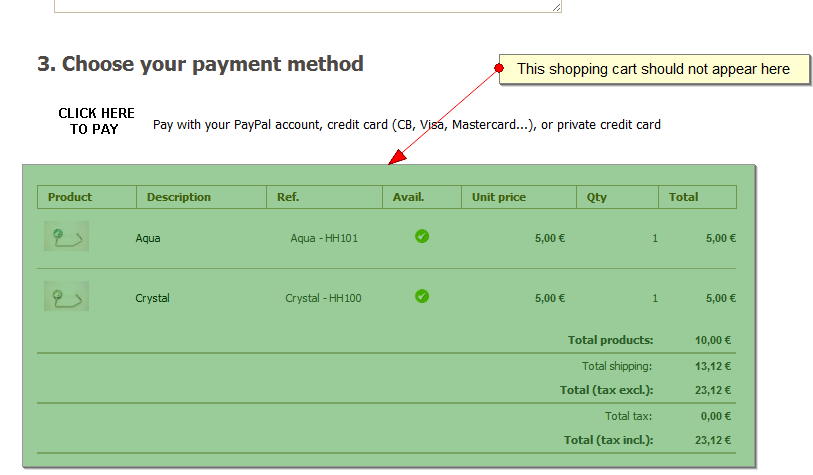

LiliekS Posted August 7, 2012 Share Posted August 7, 2012 (edited) Hi, May I know which theme version did you use for your store? We have checked your website, and there was other issue on your checkout page too. We found another shopping cart detail under 'Payment Method'. It should not appear there (see attachment). Have you modified the .tpl file before? I suggest you try and download our latest theme. We have tested it and found no problem so far with the checkout page. Hope it helps ups forgot the image Edited August 7, 2012 by LiliekS (see edit history) Link to comment Share on other sites More sharing options...
