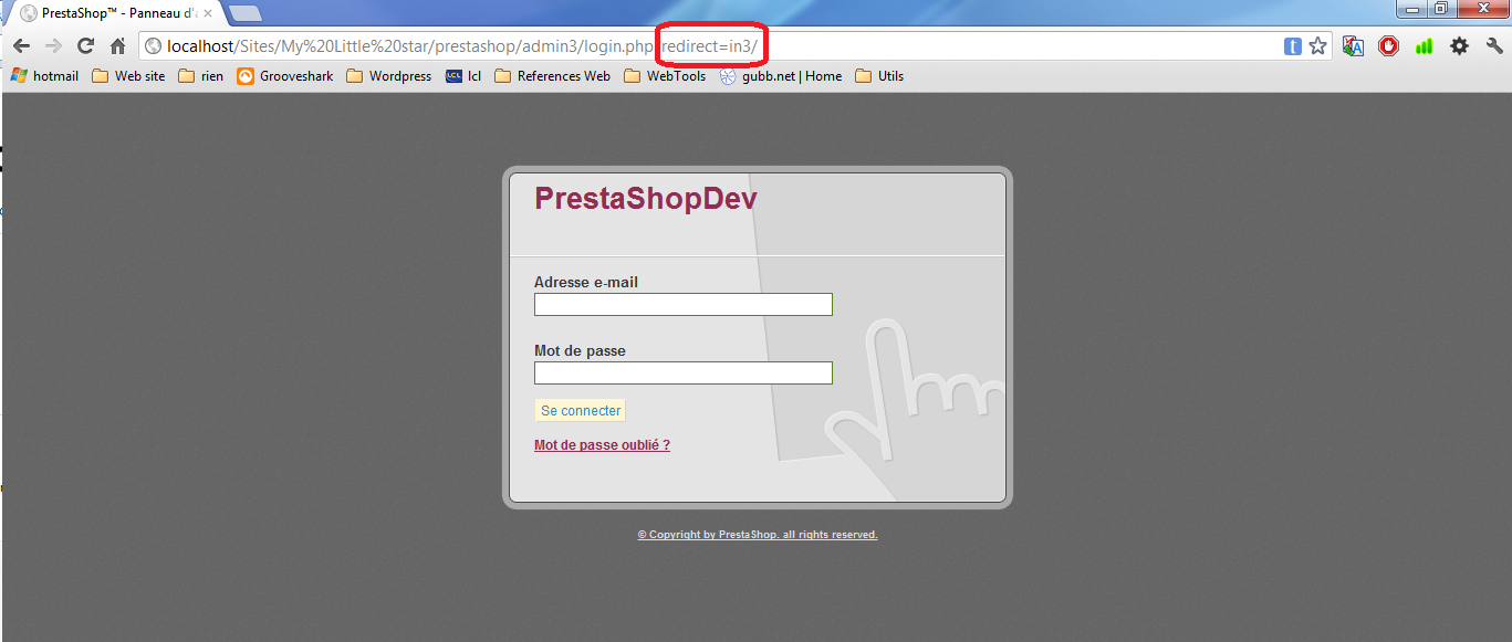

tbigueres Posted July 10, 2012 Author Share Posted July 10, 2012 So I've just reinstalled prestashop. Deleted the install folder and renamed the admin in admin3. When I type localhost/Sites/My Little Star/prestashop/admin3 to go to the backoffice it redirect me on the page attached : ?redirect=in3/ If I would have renamed my admin folder in adminMLS, it would have been : ?redirect=MLS ... That's why I was thinking of the www thing. (3 characters more). Link to comment Share on other sites More sharing options...
