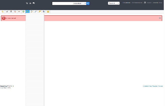

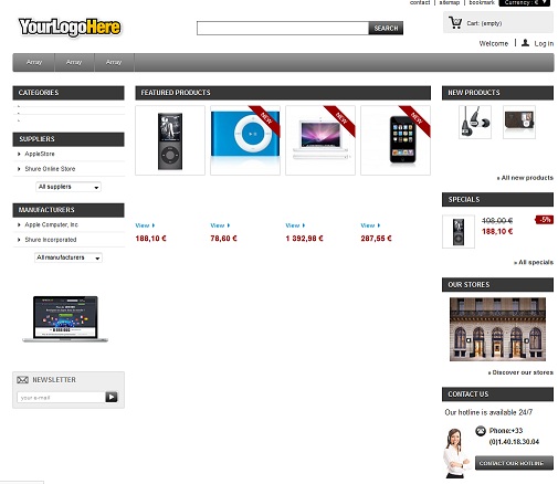

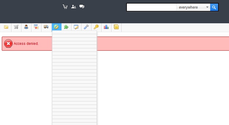

Redzor Posted July 10, 2012 Share Posted July 10, 2012 Hello, I have a strange thing going on after a fresh new installation of prestashop. The problem is when i login in the backoffice i get the message "ACCES DENIED" I can't see the modules no information nothing. Front end is behving also strange i have put some images with this post. i have searched this forum, and have nothing found yet to solve this problem. Link to comment Share on other sites More sharing options...

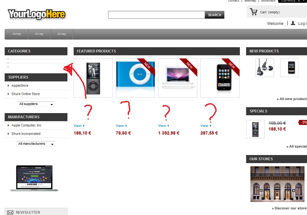

Redzor Posted July 11, 2012 Author Share Posted July 11, 2012 hello, i login with my account that i had made through the installation process. Its very strange, on the front end if you can see on the image the catogieries wont show any text and the images on the front end are missing. Maybe it is a small problem. On the installation process al the requirements where green, so its really strange. I can't look up something because i am at my work and the installation is on my computer @ home. Link to comment Share on other sites More sharing options...

Redzor Posted July 11, 2012 Author Share Posted July 11, 2012 (edited) Here are the larger screenshots. I have removed my site title from the printscreen. Additional information : The table prefix i have changed from ps into vb Through the installation process i have used the Default country: "Netherlands" Shop timezone: Amstedam Okay this is weird, In the meantime i created a new instalation of prestashop. I dindt alter anything and the webshop is now running fine. So or there is a problem with the table prefix. or with the country ? Edited July 11, 2012 by Redzor (see edit history) Link to comment Share on other sites More sharing options...

urecheatu007 Posted July 13, 2012 Share Posted July 13, 2012 Here are the larger screenshots. I have removed my site title from the printscreen. Additional information : The table prefix i have changed from ps into vb Through the installation process i have used the Default country: "Netherlands" Shop timezone: Amstedam Okay this is weird, In the meantime i created a new instalation of prestashop. I dindt alter anything and the webshop is now running fine. So or there is a problem with the table prefix. or with the country ? First of all, the problem might be related to the permisions table (ps_access), but that usually appears after a migration. I usually have this problem with older PS installations without prefix on the tables, i am too lazy to check but i suspect a hardcoded ps_ prefix in the sql upgrade somewhere. About the frontend. The demo data is in english, and when you add a new language the demo data has untranslated strings forn names, descriptions etc. You can see the rest but category names etc are blank because you don't have a dutch variant. Link to comment Share on other sites More sharing options...
