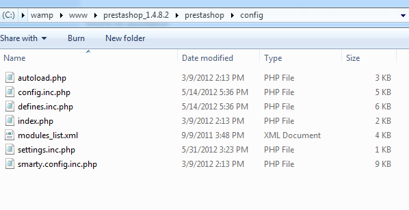

Mike Kranzler Posted July 9, 2012 Share Posted July 9, 2012 Hi creativeallsorts, It appears that the files weren't all properly transferred during the installation, as you're missing quite a few: If this is a brand new installation, I would personally recommend that you delete everything and reinstall from scratch, as there's no guarantee that these are the only missing files on your installation without deeper investigation. -Mike Link to comment Share on other sites More sharing options...

waqargill Posted December 21, 2015 Share Posted December 21, 2015 i also have the same problem but i sorted out it. i will show you how you do that. step1 . check your config folder contains must be 11 files and all the files must be consumed some bytes if you find any file who is showing 0 bytes that is the problem. step2 in my case i have two files who is showing 0 bytes one is defines.inc.php and 2nd is settings.inc.php . step3 i just put data from a new installation with both file dont forget to enter you own database info (user , name and password). that's ' all Link to comment Share on other sites More sharing options...
