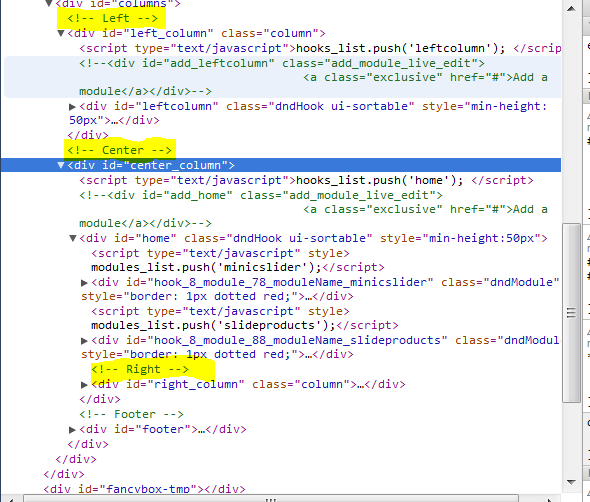

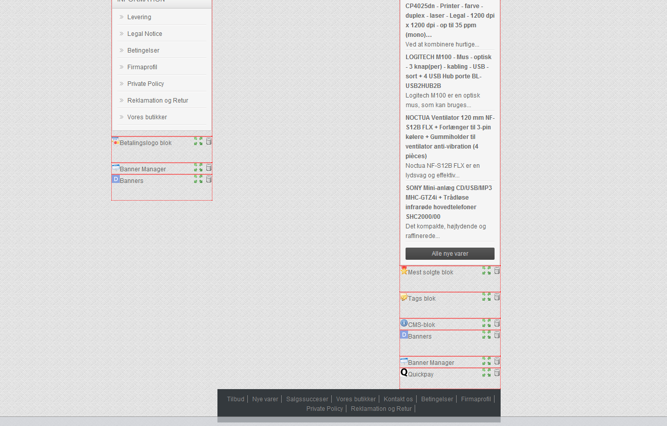

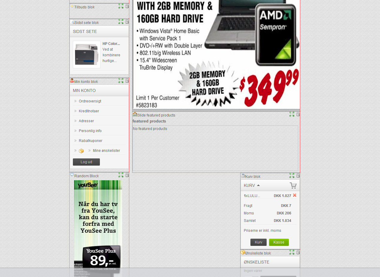

MichaelP Posted July 5, 2012 Author Share Posted July 5, 2012 okay ill try that. Just for the info i have made some extra screenshot, taken from live editing the right column strangely enough shown but below the center column It is as if the right div has come to be below the center div. Link to comment Share on other sites More sharing options...

MichaelP Posted July 5, 2012 Author Share Posted July 5, 2012 It ended up that I have taken the hard road and re-installed everything. Suddenly it happened again and I was able to detect that it was a module slide featured products v0.2 which when there was no item associated with this module made the error. Hope it can help others. Link to comment Share on other sites More sharing options...
