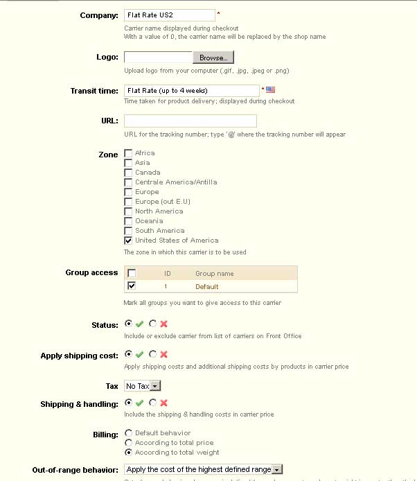

Post screen captures from FR US2 and FR US3 carrier setups. Block cart shipping price is not updating a common problem. Search forums for some suggestions to solve it.
Thanks. Here are the screen captures for Flat Rate US2 and Flat Rate US3.
post-373480-0-51766500-1341441167_thumb.jpg post-373480-0-72371400-1341441181_thumb.jpg
Okay, I finally figured out the problem. Thanks, phrasespot for giving me other options to check in the forum. I'm very new to PrestaShop and the forum and didn't know what to search by.
For anyone else having the problem of multiple carriers showing up during checkout, it's most likely because you need to change the out-of-range behavior under carriers. Mine was set to "Apply the cost of the highest defined range," which brought up everybody, pretty much, because I set that range for every one of my carriers. Changing that option to "Disable carrier" did the trick for me.
