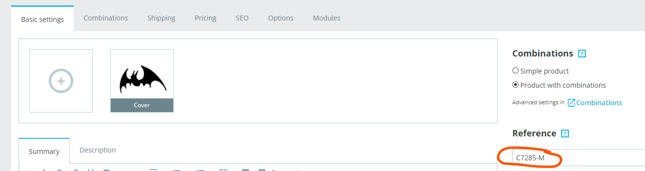

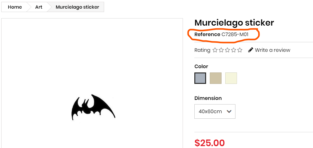

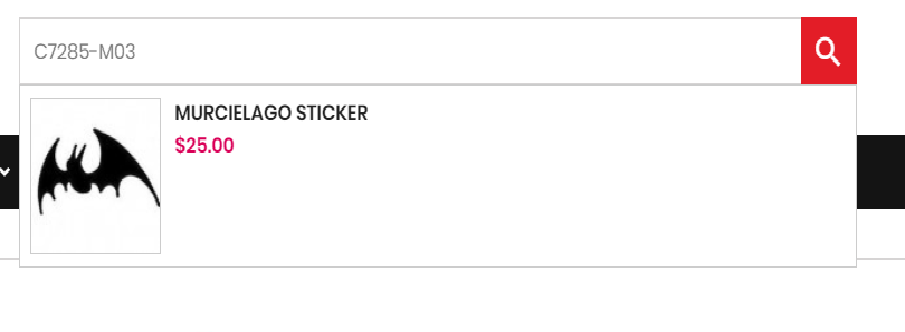

Ezequielb Posted May 9, 2020 Share Posted May 9, 2020 (edited) I have Prestashop 1.7.6 and this featured is alredy working with no modules at front and back office( am using a custom theme). The thing nobody have solved yet is: A Product was created with reference C7285-M (main product before combinations). Then combinations were created: -C7825-M01 (Default combination) -C7825-M02 -C7825-M03 -C7825-M04 etc... When customer searchs the shop for C7285-M03 combination which is not the default one, the results always take the customer to the default combination view which is C7285-M01. I have tried many options with the same result. This creates many issues with customers purchasing the wrong products. Is there a way to get the result linked to the correct product search?? See attached pictures Edited May 9, 2020 by Ezequielb (see edit history) Link to comment Share on other sites More sharing options...
PGS_BB Posted March 16, 2022 Share Posted March 16, 2022 Hi On 5/9/2020 at 5:48 PM, Ezequielb said: I have Prestashop 1.7.6 and this featured is alredy working with no modules at front and back office( am using a custom theme). The thing nobody have solved yet is: A Product was created with reference C7285-M (main product before combinations). Then combinations were created: -C7825-M01 (Default combination) -C7825-M02 -C7825-M03 -C7825-M04 etc... When customer searchs the shop for C7285-M03 combination which is not the default one, the results always take the customer to the default combination view which is C7285-M01. I have tried many options with the same result. This creates many issues with customers purchasing the wrong products. Is there a way to get the result linked to the correct product search?? See attached pictures Expand Hi Did you solve this? Having the same issue. Link to comment Share on other sites More sharing options...
