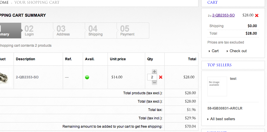

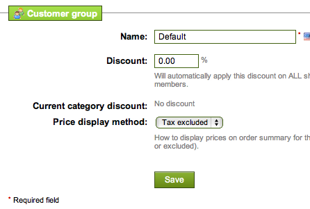

michaelvila Posted June 23, 2012 Author Share Posted June 23, 2012 (edited) Thanks for the quick response, tdr170, and great videos, Curt Donohue is always very thorough. I finally got it to work by going into the catalog, selecting a product, and changing the tax rule to my tax rule, but it will not work in the cart without including the tax in the price. Curt demonstrates how to just show tax in the cart by going to: Payment/Taxes then select 'Display tax in cart', but it's not working for me? I also thought the change would affect all my current products. So I have around 500 items, is there a way to make a global change, to all the products all at once? Curt mentions going back and changing each product! I hope that's not the only way? Thanks again Edited June 23, 2012 by michaelvila (see edit history) Link to comment Share on other sites More sharing options...
