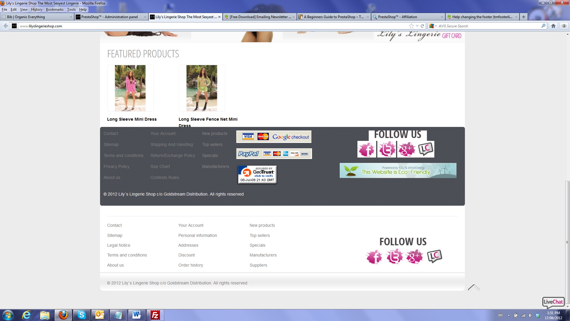

natebc Posted June 17, 2012 Author Share Posted June 17, 2012 (edited) Is this what you are looking for: I see that you added the copyright to the easyfooter but thought I would give you some input anyway. To make this happen you need to add a line to the prestaloveeasyfooter.css file under the heading .block-prestalove-easyfooter - add - margin-top: -270px Will look like this .block-prestalove-easyfooter{ float: left; width: 100%; padding: 20px 0; margin-top: -270px } This actually moves the easyfooter over top of the other footer, so you could remove the links from the tmfooter and leave the copyright and you will have what you originally posted on. Thanks for the reply, YES that's what I'm looking for but where can I delete the other (Follow Us) icons ("tmcontacts") PS I just did what you told me and add the line you told me ( margin-top: -270px). this is what happen in photo. Edited June 17, 2012 by natebc (see edit history) Link to comment Share on other sites More sharing options...
natebc Posted June 17, 2012 Author Share Posted June 17, 2012 (edited) After that I Disable the TM Footer Links and then re-enable it know the site looks like this. Edited June 18, 2012 by natebc (see edit history) Link to comment Share on other sites More sharing options...
tdr170 Posted June 17, 2012 Share Posted June 17, 2012 (edited) if you disable the easyfooter then re-enable it should be back to the bottom. I did not mean for you to disable the tmfooter just remove the links, I do not use that footer so not sure if that is part of the configuration or if you will need to comment out some lines in the tpl file. I see that you have removed the margin-top form the css file after you get things back to the way they were, you can use the -270 or make it what ever # positions things the way you want them. Edited June 17, 2012 by tdr170 (see edit history) Link to comment Share on other sites More sharing options...
natebc Posted June 18, 2012 Author Share Posted June 18, 2012 if you disable the easyfooter then re-enable it should be back to the bottom. I did not mean for you to disable the tmfooter just remove the links, I do not use that footer so not sure if that is part of the configuration or if you will need to comment out some lines in the tpl file. I see that you have removed the margin-top form the css file after you get things back to the way they were, you can use the -270 or make it what ever # positions things the way you want them. OK, I have disable the easyfooter then re-enable it. But the only then is that the easyfooter did NOT go back to the bottom it still on the TOP. Would you know any other way of getting it back to the bottom. Nate Link to comment Share on other sites More sharing options...
