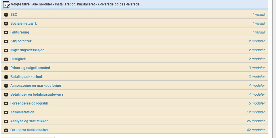

joachim.niclasen Posted June 13, 2012 Share Posted June 13, 2012 Hi there I suddenly ran in to this problem today: Usually all my products show on my index page but they have now disappeared. I have the Advanced Search 4 module installed but nothing happens when I try to filter. Actually it seems like something is wrong with this module - it seems almost "dead". Another one of the modules I have installed myself are gone too. So I tried to have a look at the configuration of the Advanced Search 4 module but found out that I can't access any module. The "modules tab" works fine. The problem is when I try to access any of the filters. I get a 404 error no matter what module-filter I try to access. Before this happened I did make a few changes to some of the Prestashop-files but I can't see that this should be the problem. (I made a little change to the blockpaymentlogo.tpl file by adding some new logos). Could it be a hosting problem...? I really hope that someone can help here! Link to comment Share on other sites More sharing options...

joachim.niclasen Posted June 13, 2012 Author Share Posted June 13, 2012 No they are not missing. At least I don't think so. The problem is when I get to the modules-filters (see attachment). When I try to access for example "administration" I get the 404 error - page can not be shown Link to comment Share on other sites More sharing options...

joachim.niclasen Posted June 13, 2012 Author Share Posted June 13, 2012 @Mike Yeah sorry I must have forgotten. The attachment just shows where it all goes wrong. @Golan I will contact my host. Thanks. The second part I didn't understand. Link to comment Share on other sites More sharing options...
