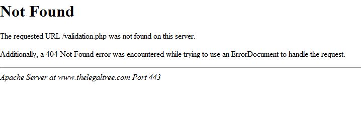

[email protected] Posted June 12, 2012 Share Posted June 12, 2012 I really need help! I have spoken with Prestashop Tech support and they are baffled. I cannot get Authorize.net to work with the latest version 1.4.8.2. Here is the error message I am getting: Not Found The requested URL /validation.php was not found on this server. Additionally, a 404 Not Found error was encountered while trying to use an ErrorDocument to handle the request. Apache Server at www.thelegaltree.com Port 443 I have my correct login id and key for my merchant account, and I have my merchant account on test. I have toggled back and for changing the PS module to Production and Test...neither one work... Can anyone help me? Thank you in advance! Link to comment Share on other sites More sharing options...

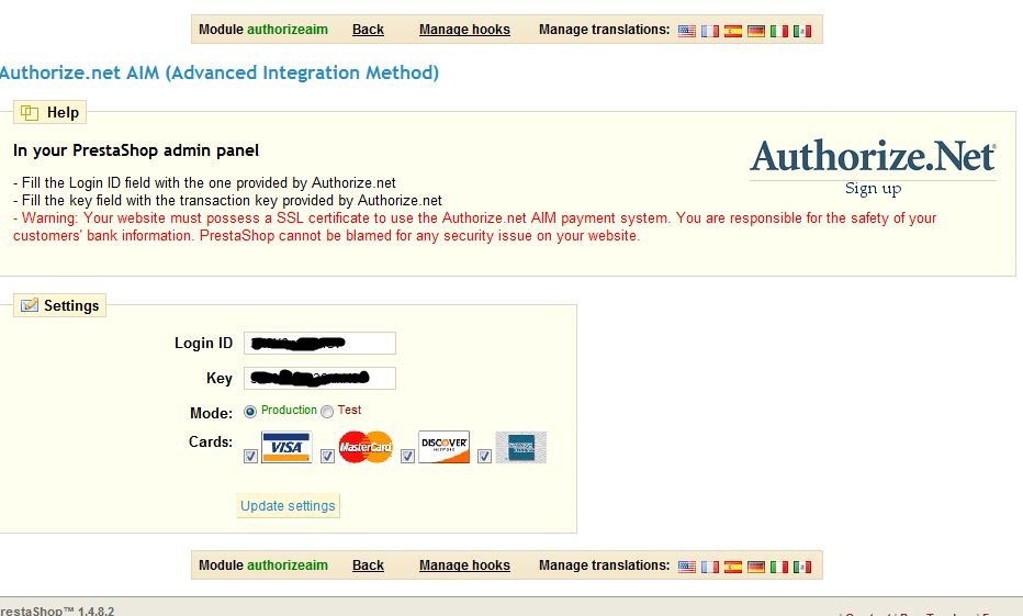

Mike Kranzler Posted June 12, 2012 Share Posted June 12, 2012 ok...I changed to production on both....still same error message. I really do appreciate you working with me on this! Thank you! Can you please post a screenshot of the error, and of your configuration of the Authorize.net module in your Back Office? Feel free to black out the private information such as credentials. -Mike Link to comment Share on other sites More sharing options...
[email protected] Posted June 12, 2012 Author Share Posted June 12, 2012 ok...I am new to this forum...how do I post the images? Link to comment Share on other sites More sharing options...
Mike Kranzler Posted June 12, 2012 Share Posted June 12, 2012 ok...I am new to this forum...how do I post the images? Use the "More Reply Options" button, and then attach the images and click "Add to Post" for each one. -Mike Link to comment Share on other sites More sharing options...
[email protected] Posted June 12, 2012 Author Share Posted June 12, 2012 ok..Here they are Link to comment Share on other sites More sharing options...

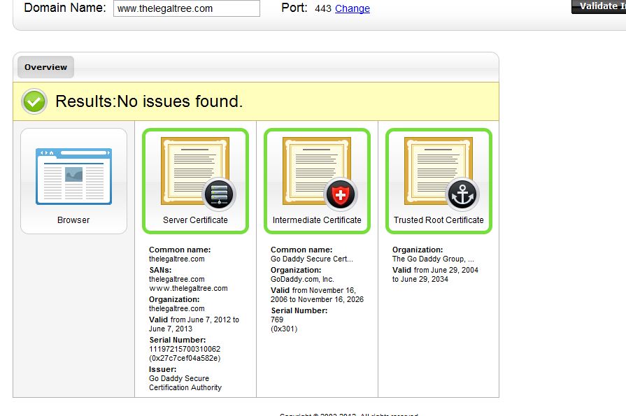

Mike Kranzler Posted June 12, 2012 Share Posted June 12, 2012 ok..Here they are Does your site have an active SSL certificate? -Mike Link to comment Share on other sites More sharing options...
[email protected] Posted June 12, 2012 Author Share Posted June 12, 2012 yes...it is with godaddy.com Link to comment Share on other sites More sharing options...
Mike Kranzler Posted June 12, 2012 Share Posted June 12, 2012 yes...it is with godaddy.com And what is your site's URL? -Mike Link to comment Share on other sites More sharing options...
[email protected] Posted June 12, 2012 Author Share Posted June 12, 2012 www.thelegaltree.com Link to comment Share on other sites More sharing options...
[email protected] Posted June 12, 2012 Author Share Posted June 12, 2012 ssl Link to comment Share on other sites More sharing options...

Dh42 Posted June 13, 2012 Share Posted June 13, 2012 Chad, give me a shout when you get a chance. I bounced a couple transactions off of your auth account so I think the problem is the way that Prestashop has written the form for the plugin. They are trying to access validation.php from the site root and not the module folder. When I get on my actual pc in a few minutes I will post a fixed file that should get you working. Link to comment Share on other sites More sharing options...
Dh42 Posted June 13, 2012 Share Posted June 13, 2012 Chad, I actually forgot that you created me an account in the backend. I just went ahead and installed the module and it should be working right. You might turn on your test mode in your auth account and and in the module and try a couple test payments. But everything should be working right. You might have to hand type your auth key and api login back in because I just copy and pasted them. Sometimes doing that they pick up extra characters and won't work. Mike, the problem with the module that ships with 1.4.8.2 is on the line 33 in the authorizeaim.tpl it has <form name="authorizeaim_form" id="authorizeaim_form" action="{$new_base_dir}validation.php" method="post"> and it needs to read <form name="authorizeaim_form" id="authorizeaim_form" action="{$module_dir}validation.php" method="post"> When it was giving a file not found error on the validation.php file it was looking for it in the site root, not the modules folder. Link to comment Share on other sites More sharing options...
