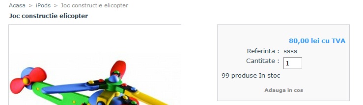

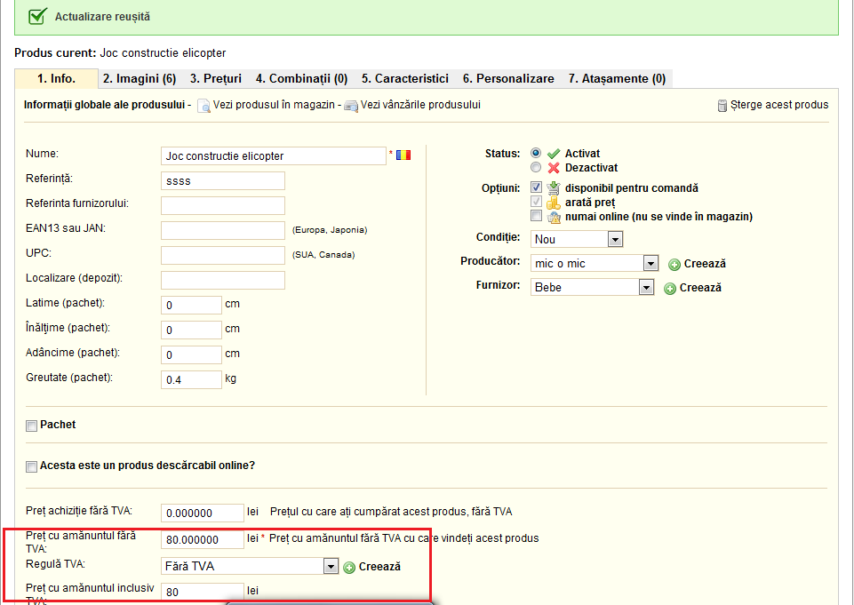

lightsb Posted June 13, 2012 Share Posted June 13, 2012 (edited) Eu m-am jucat un pic pe local .. am activat TVA-ul de la payment >> taxe, dar pe fiecare produs poti alege la regula TVA >>> fara TVA si functioneaza. Am atasat 2 print-screen-uri Acum depinde de traducerile pe care tu le ai .. si ver. de presta. Bafta. Edited June 13, 2012 by lightsb (see edit history) Link to comment Share on other sites More sharing options...
